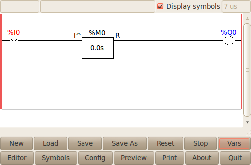

This is a sample CL program I was thinking of.
the input is connected to spindle-on. It is edge sensitive - true only when going from true to false.
the output is connected to your spindle drive contactor. It is inverted so is normally closed, so you can turn the spindle on
The monostable is set for 1 second, which breaks the contact for 1 second.
Chris M
Chris M
