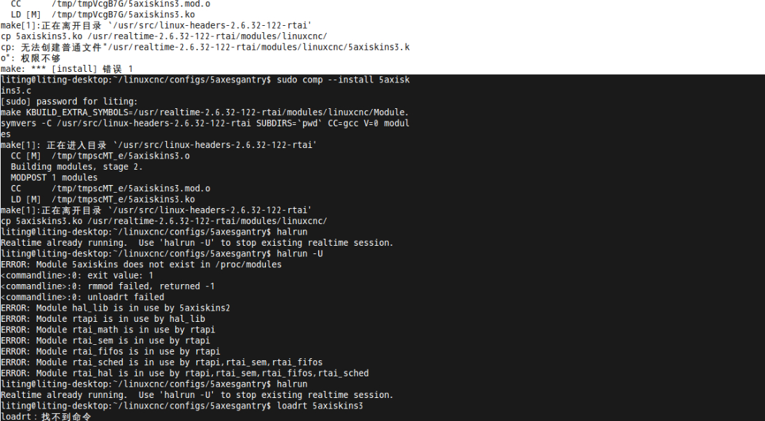

I want to recompile my 5axiskins.c ,
after the success of compilation, appear errors
also, halrun -U doesn't work unless I restart my computer~~
how to solve it?
how to solve it?

Replied by ArcEye on topic compile error about HAL component
Re-boot
You tried to run halrun whilst another instance of linuxcnc was already running or had not cleanly unloaded
halrun -U seldom works

- Posts: 23527
- Thank you received: 5005
17 Dec 2013 21:26 #41698
Often a module will compile without errors, but will then crash at runtime.
When that happens it leaves RTAPI in a misconfigured state, and nothing can sort things out other than a reboot.
I have never had halrun -U achieve anything useful.
I suspect that there is a problem in your 5axiskins, but the error report there doesn't show the necessary information.
Replied by andypugh on topic compile error about HAL component
