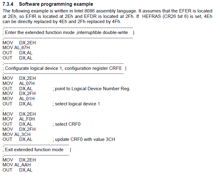

- mariusl
14 Jan 2014 20:26 #42758
by mariusl
Regards
Marius
www.bluearccnc.com
Replied by mariusl on topic Driver for hardware IO port
Guys, I downloaded the data sheet and found this piece of example how to setup stuff. This is not for the coirrect port but the information is there.
What do you think please?
Regards
Marius
www.bluearccnc.com

14 Jan 2014 20:40 #42759
by mhaberler
Replied by mhaberler on topic Driver for hardware IO port
I think you should:
- post the exact chip number so we know what you are talking about
- google for 'winbond <chip number> linux driver>' and see something comes up
-m
-m
- mariusl
14 Jan 2014 21:01 #42761
by mariusl
Regards
Marius
www.bluearccnc.com
The chip is the Winbond SuperIO W83697HG. It handles all the peripherals like LPT and USB etc.
Look at this link where the guy shows some code to interface with this chip. Look at theline and in specific the GPIO 10 - 17 as they are the ones that I want to use.
some code sample to write to most registers
Also see what this guys says.
WDT sample with good description
No drivers found yet

14 Jan 2014 21:09 #42762
by mhaberler
gotta try a bit harder: www.lm-sensors.org/ticket/2131 - "The W83627HG is the lead-free version of the older W83627HF chip,"
ah! lxr.free-electrons.com/source/drivers/hwmon/w83627hf.c and lkml.indiana.edu/hypermail/linux/kernel/1201.2/00090.html
you have a starting point. Whether that few pins are worth the coding safari is a different matter.
- Michael
