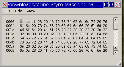

Hi
This is the error
If you load your hal file into a proper Linux editor, there is a stray unprintable charactor which is rendered as a dot in front of the # on line one
Delete that, or the whole line and it should run
regards
PS
In fact if you put it through a Hex editor, there are 3 unprintable chars before the 0x23h char which is a #
If you edited this in a windoze editor or word processor, then this is why you should not
This range of charactors are used in unicode with languages that have charactors with diaeresis etc, so that could be something to do with it.

- etnur
- Posts: 19
26 Jan 2014 22:21 #43198
by etnur
Replied by etnur on topic Error by startup 4 axis machine
Thank you for the tip, I never have to find that.
I have clean the hal file and search at the similar failure in the ini,
but emc don't run.
The error message is the same.
Here the copy of the error window and the cleaned files.
THK for your Job.

by ArcEye
No the message is not the same
This time you have a carraige return in the wrong place, pushing the variable 'SERVO PERIOD' onto line 6
(line 5) loadrt [EMCMOT]EMCMOT base_period_nsec=[EMCMOT]BASE_PERIOD servo_period_nsec=[EMCMOT]
(line 6) SERVO_PERIOD num_joints=[TRAJ]AXES
Change it to
(line 5) loadrt [EMCMOT]EMCMOT base_period_nsec=[EMCMOT]BASE_PERIOD servo_period_nsec=[EMCMOT]SERVO_PERIOD
(line 6) num_joints=[TRAJ]AXES
and hopefully will now run
regards
Meine-Styro-Maschine.hal:5: Empty variable name.
Change it to
regards

So the Simulation RUN
I delete the first lines, then there came three new mistakes that, however, I could repair.
Thank you for your support.
Best regards FR
