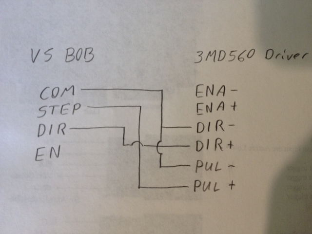

Hello,
This is my first time modifying a HAL file. I need to switch from the default "0" type steppers to type "3" I think I have most of it figured out from the HAL and StepGen Manuals but I am stuck on formatting for the "step" comands.
I am running 3 Phase, full step motors.
I read the manuals as asking for the following but HAL errors and does not initialize:
net xstep <= stepgen.0.phase-A
net xstep <= stepgen.0.phase-B
net xstep <= stepgen.0.phase-C
What am I doing wrong/what is the proper format?
Thanks,
Travis

Replied by PCW on topic Proper format for 3 Phase STEPGEN step sequence?
if you have direct drive 3 phase outputs it would likely be something like this:
net xstep-a parport.0.pin-2-out <= stepgen.0.phase-A
net xstep-b parport.0.pin-3-out <= stepgen.0.phase-B
net xstep-c parport.0.pin-4-out <= stepgen.0.phase-C

Replied by punitor1 on topic Proper format for 3 Phase STEPGEN step sequence?
Thanks PCW,
I have a very simple BOB controlling the drivers, I have attached a quick controller/driver wiring diagram
I should have mentioned that the 3MD560 driver has enable - default enabled, although I have tried it both ways.
T
Ahh thats a standard step/dir drive so the stepgen is just mode 0
so there are no changes needed in a normal stepconf
generated hal file.
The only thing different may be the scaling
generated hal file.
The following user(s) said Thank You: punitor1

As PCW has said, that is a normal step-dir drive, so is controlled entirely normally with a Mode 0 stepgen.
You might want to wire with +5V to the + pins and connect the parport / BOB to the - pins. This would certainly be a better arrangement with a direct parallel port connector (typically parports can sing 15mA but many can only source 3mA). The BOB probably removes this limit.
The problem with your HAL:
Is that you are trying to connect three outputs to the same signal (xstep), and a signal can only be driven by a single output (otherwise which value should it believe?)
Note that signal names in HAL are not special, you get to make them up. The same is not true of HAL pins, those have to exist.
The signal name is the first thing after net, and must always exist.

Thanks PCW and andypugh,
I reverted the file to 0 type and rewired for a +5v common and - signal and it works:)
Now I just need to get the scaling adjusted (steppers are jumpy) and I should be good to go.
Thanks again for your help,
Travis
