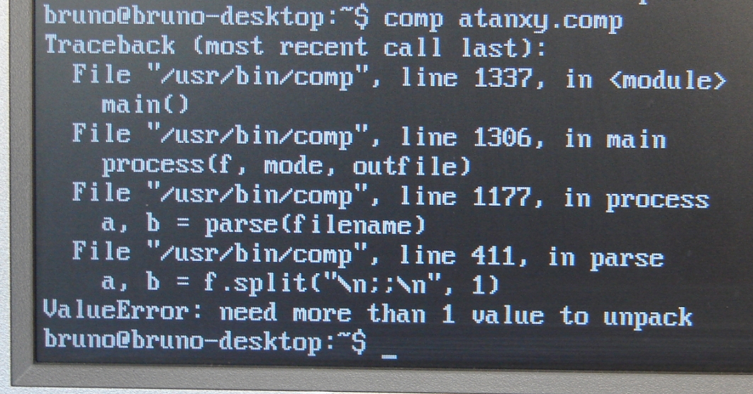

How compiling this component ?

Hi
There is no terminating semicolon after PI
Suspect that is it, parse routine not finding line termination to work on.
regards
FUNCTION(_) { out = atan2 (in0,in1) * 180 / PI }
regards

Hello ArcEye
thank you for your answer
Yes sorry
but after correcting the problem is the same.
same post after "$ comp atanxy.comp" ??
Yes sorry

Hi
I think it is just a case of the python parser not being as good at resolving obfusticated C as cpp
This seems to compile fine
regards
component atanxy;
pin out float out;
pin in float in0;
pin in float in1;
function _;
license "GPL";
#include <rtapi_math.h>
#define PI 3.141592653589
FUNCTION(_)
out = (atan2 (in0,in1) * (180 / PI));
regards

I am not using the same version of comp probably and I did not install the component, just built it.
Try comp --compile atanxy.comp
and be sure that the new one is in the path not the old one
regards
regards

Hi
I am working on another partition and cannot test just yet
I did notice however that the atanxy.comp is littered with ^M charactors, which I suspect means it has been edited under windows
That in its own can produce an error
Try cutting and pasting the version I posted into gedit and then compile it
regards
regards

Yes you're right, this is the problem!
But I wrote my atanxy.comp and my sincos.comp in gedit ??
and in gedit, my atanxy.comp and yours are identhique
(I wonder if I is not a keyboard problem)
