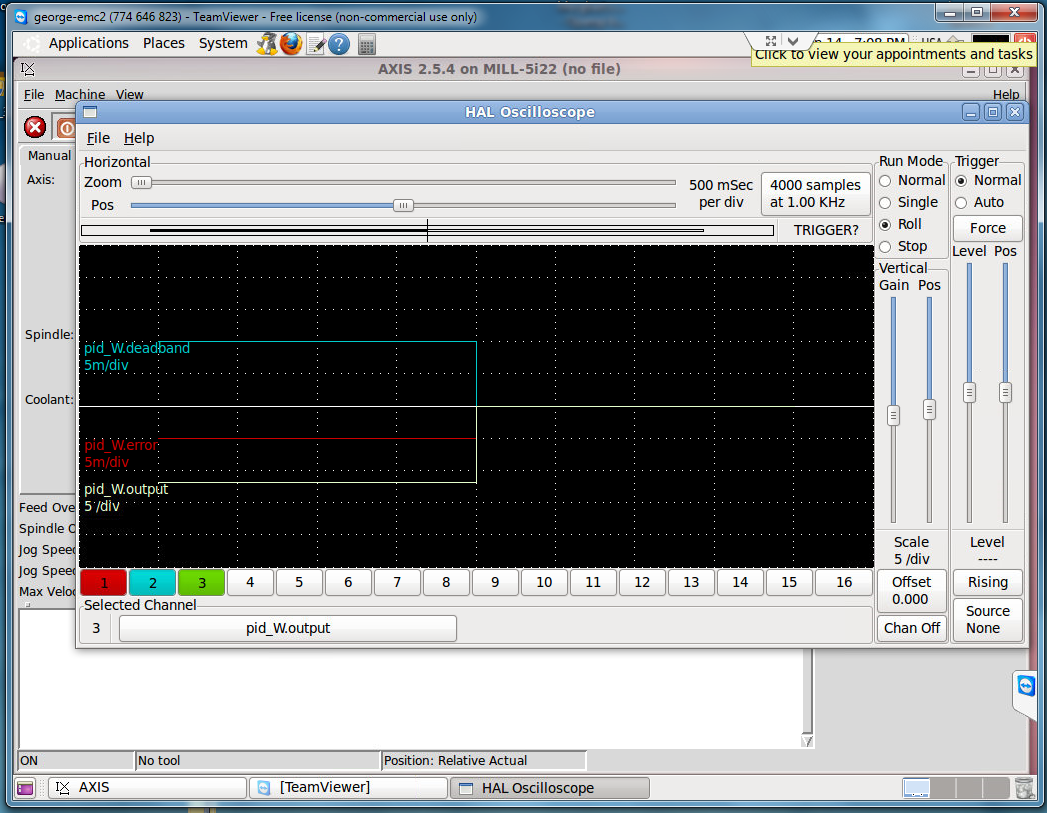

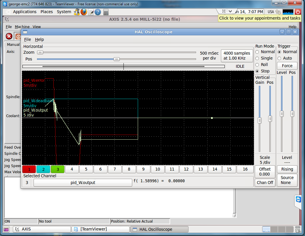

- kostas
- Posts: 111
- Thank you received: 6
14 Jun 2014 23:19 #47967
by kostas
Replied by kostas on topic PID output on unmoving axis causes motor overheat
Here are the screenshots. The first is after a small W motion and the second after some seconds where I can see no observable activity.

Replied by PCW on topic PID output on unmoving axis causes motor overheat
Is there a static load on the W axis?
Your tuning make its seem that these are torque mode drives so a fairly large torque
output when idle is possible.
What it looks like is happening is this:
Integral term builds up to a large enough torque to overcome static friction
and pull the motor to within the deadband. Once in the deadband, the integral term is frozen
so the PID output stays at the last torque setting, which is not enough to actually move the motor
but enough to cause an eventual overheat. This may be related to high static friction or a static load on W
Also your PID output of 12/98 is only about 1/8 full torque so I would not expect this to cause
overheating, this shoud probably be looked into also
