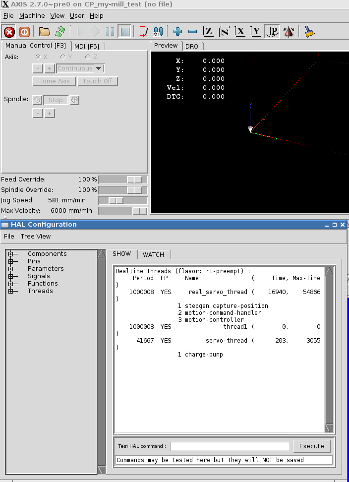

31 Oct 2014 23:30 #52624 by ArcEye
Replied by ArcEye on topic Charge Amp Frequency
Hi
HAL: ERROR: thread 'base-thread' not found
CP_my-mill_test.hal:26: addf failed
I managed to make a sim to test this.
The reason is that base-thread has not been created, instead it is called thread1
Why this has happened is another matter altogether
You will also note that the servo-thread has been given the rate that was supposed to be for the base-thread and that thread1, which should be the fastest thread, is the default 1000000ns
I am not sure what is happening here, I will try some experiments.
There are some other issues with the hal file, you are creating a signal called charge-pump with this line
net charge-pump <= charge-pump.out
but that is not the problem right now
regards

01 Nov 2014 23:29 #52667 by ArcEye
Hi
I have finally got to the bottom of this, through something Andy mentioned which is not in the docs for threads.
Not only do threads have to be created in order of frequency speed, fastest first, but the ascending threads need to be multiples of the fastest one.
So if your fastest thread is 30000, you can create a second thread of 60000 or 90000 but not 40000.
This had not cropped up previously because I actually wanted a much slower thread which presumably was a multiple of the fastest one, even though I had not done so consciously.
What this means is that you cannot have a fast thread of say 40000 for your charge pump, unless your new 'servo-thread / base-thread' is 80000 and the extra thread is 1000000 to replace the old servo thread
This will probably restrict your steppers considerably, for the sake of getting a charge pump to work
I should first see if your base thread will activate the charge pump as it is. I have no idea if you have actually tried this or just looked at the figures and thought it would not.
If you have tried the config, but could not get it out of Estop, that is not the same thing.
stepconf has never given me a config which works with the charge-pump activated BOBs I have and I had to change the logic to get both Estop and charge-pumps to work.
If that does not work, try making your base thread 42000 say and see if the charge pump works AND the steppers operate OK
That will be far better than trying to run an extra thread
regards
