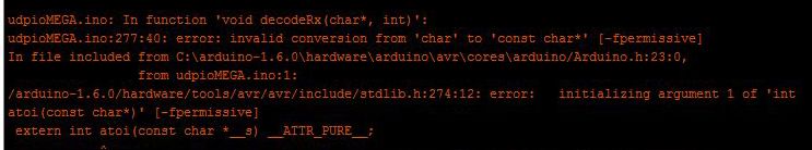

@gerritv: Marius specifically made it clear in his last post that he has not looked at the Mega port, it is not his code.
udpioMega.py:
#!/usr/bin/python
#udpioMEGA.py
# HAL userspace component to interface with Arduino board
# Copyright (C) 2015 Marius Liebenberg <This email address is being protected from spambots. You need JavaScript enabled to view it.>
# Mods to use Mega2560 Robi Akerley-mcKee <This email address is being protected from spambots. You need JavaScript enabled to view it.>
udpioMEGA.ino:
void decodeRx(char* rxbuffer, int buflen)
if(rxbuffer[0] == 'D') {
STEPPORT = atoi(rxbuffer[STEPPORTDATA]);
DIRPORT = atoi(rxbuffer[DIRPORTDATA]);
XTRPORT = atoi(rxbuffer[XTRPORTDATA]);
for(int i=0; i< PWMCOUNT; i++) {
analogWrite(pwmpinmap,atoi(rxbuffer[PWMDATA + i]));
return;
STDLib.h :
extern int atoi(const char *__s) __ATTR_PURE__;
ERROR: char * cannot be translated into atoi (const char * ....)
forum.arduino.cc/index.php?topic=474206.0
I hope I was clear?

I have been looking into this issue and found using either:
STEPPORT = (int)(rxbuffer[STEPPORTDATA]); //Casting char buffer in rxbuffer[STEPPORTDATA] to an (int) then assign to STEPPORT seems to work.
My main issue now is bypassing the gwibber library, I don't understand why this is used and how to create a work around
(been experimenting with:
#received = service.recv(150) #Gwibber function for receiving data - no idea what it is
received = service.recvfrom(150) #USING SOCK instead of gwibber
But experiencing other problems
