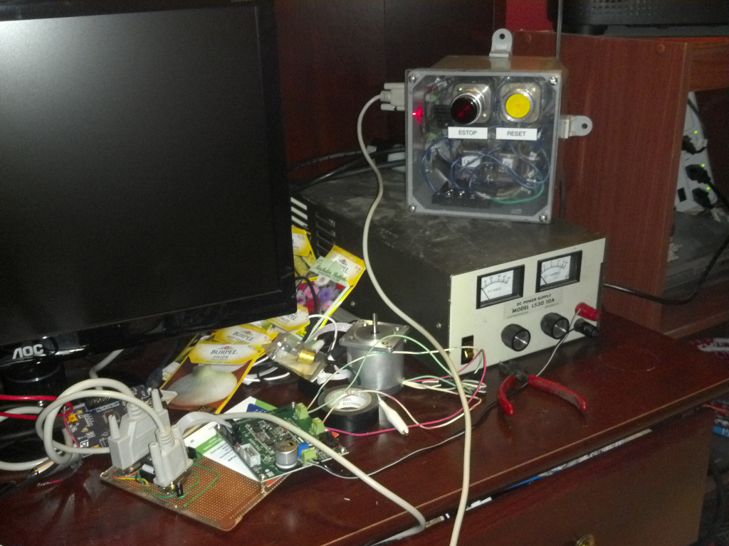

09 Apr 2015 04:21 - 09 Apr 2015 04:49 #57641
by yeltrow
Replied by yeltrow on topic SPI bus generic driver and ST L6480
2015-04-08-21_59 IT WORKS!!!!
BTW -- If you decide to use one of the EVAL6480H boards, be sure to put a resistor onto the reset pin (see attached schematic). I forgot about the little zener clamp diode and send over and amp into the clamp diode. Luckily, it failed shorted and protected the chip when I unplugged the ribbon cable. If it had burned in half, the full drive supply voltage could have been put across the reset pin and cooked it. I had a 3.3V zener of the same surface mount size and repaired the drive tonight. I have also modified the jumper settings on the board so I can force 5V into VDD through the spi ribbon cable. The drive works with the jumper settings either way, but could be producing very weak signals back to the PC which would be more succeptable to noise. Below is the readme for this file set:
Hurray!!! It works! I have a single axis working seamlessly over the spibus with
an external estop. The driver can now run a single axis and react appropriately
when the estop button is pressed. I have my new breakout board prototyped up that
pipes the e-stop signal to the reset line so the chip is held in reset as soon
as the estop circuit activates. The noEstop input pin on the stm.comp component
will drop back to initialize the drive when it sees a 0 indicating the estop circuit
has been tripped. It will then sit in a loop continuously querying the drive
until it gets sensible status information from the drive. It then loops checking
all of the configuration parameters to make sure they are correct and then proceeds
to a "ready" state when successful. I have added a totally bogus charge pump output
on pin 17 to enable my estop box.
Next Steps:
1) The charge pump output needs tied into the estop buttons on Axis.
2) Tie in some sort of monitoring of the feedback from the motor to make sure
it is valid. Currently I am integrating the velocity commands and computing
when I should have seen a step change from the controller's internal position
counter. Under high accelleration, this method isn't perfect. It isn't set
as any kind of a fault yet. It should be so we know if the drive is being stupid.
3) Testing with multiple axes.
4) Testing for interference with the big motors and power supply on the mill.
5) Relocating the components to their new home in the control panel on the mill.
6) Integration of mill limit switches
7) Integration of oiler, coolant, spindle control, jog wheels, maybe encoders, and
other goodies.

- mariusl
09 Apr 2015 09:25 #57643
by mariusl
Does this hold true for all three channels? How many bytes do you get to read per cycle?
This looks really great so far. I have done a set of I/O cards that work on SPI or I2C. They can daisy chain to multiply. I will have a look at adapting them to fit your scheme at some stage. I only have a very basic driver to test with for now. I always intended for the I/O to go on a second parport and leave the first parport for the motors.

My base plan is to have a dedicated spibus for each axis (3 or 4 in total). If I can prove that my following errors are small enough with a 3ms servo loop, I can put all of the drives on one spibus. I have not proven that yet. To keep the axes together, I use a PID loop with a feed-forward velocity coefficient of 1 (FF1) so the motor is really getting a velocity command slightly tweaked by the position error to compensate for delays and clock skew. It is adorable that the little stepper thinks it is a servo
I use the RUN(dir, speed) mode to run the motor at a velocity. I then use the PID to close the position reported by the L6480 against the command position. With pretty aggressive acceleration, I can still maintain a < 0.001 inch following error, so that isn't too bad. I dislike using the PID (which is all P in this setup, the I comes from position being the integral of velocity), but with the heavy FF component, it is just trimming the position a touch. I have also created a delayline component as an experiment to make the PID only trim against the position command that it has had time act against. I found that the position error from a command 4ms ago was always VERY small. I don't really care if my parts come out 4ms later than I commanded them to, so I am considering telling axis that the position is the command position + the pid error from 4ms ago. It reduces the closed loop bandwidth considerably, but it appears I may not need it. This may even suggest that 3ms updates would be fine. A real encoder could be used instead, and I am considering that, too. Every loop cycle i send GET_PARAM ABS_POS and RUN VELOCITY. It is nice that I get to receive the ABS_POS while I am clocking out the data for how fast to go. I have been simulating (with hardware in the loop) speeds of up to 60in/minute with 5TPI leadscrews. At 60 in/minute, the motion planner seems to like to make rounded corners anyway, so my loops may be the least of worries if I am running that fast. I predict most of the time I will be running in the <10in/minute speed range.
- mariusl

It is sounding like a good solution. I like what you are doing here man.
I am going to use a stm32 as base unit and then I might be able to run at 1ms loop time.
