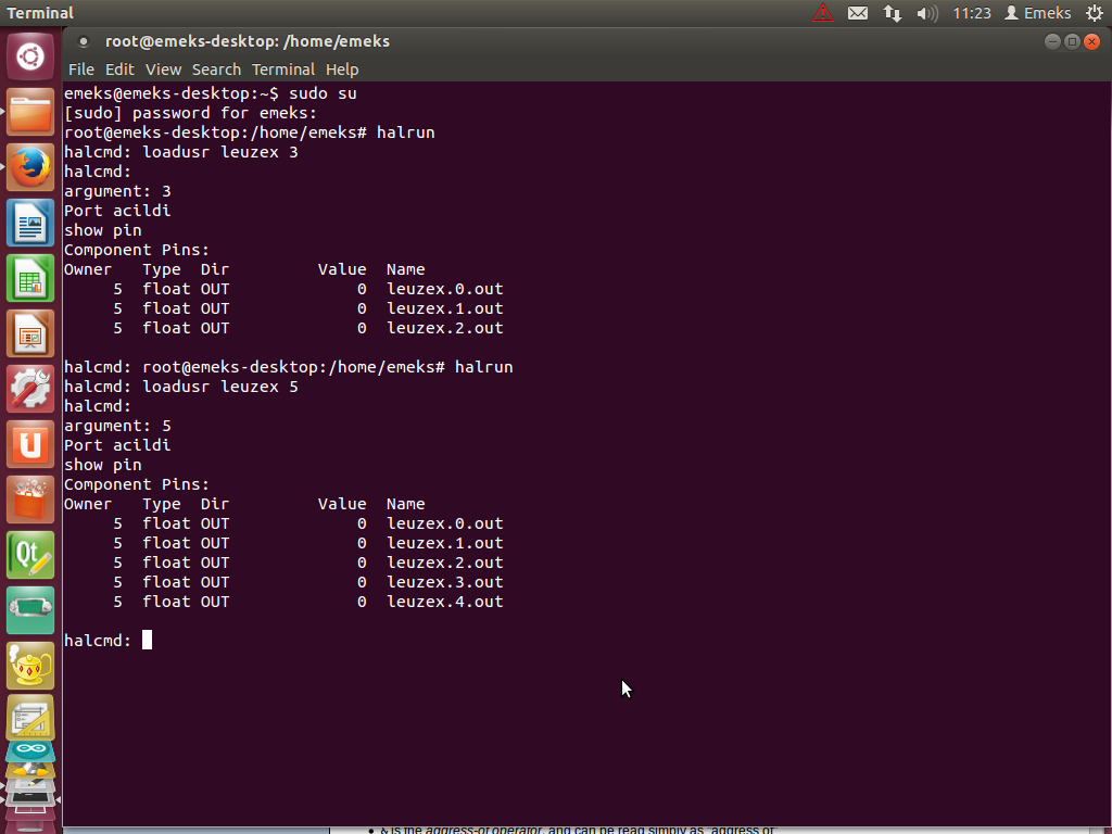

02 Mar 2015 15:11 #56394 by Fuzzy_Mind
Replied by Fuzzy_Mind on topic loadusr command with multiple instance
Hi
Thanks for your replies but I'm new on linuxcnc and I couldn't figure out.
Here is my code:
component leuze;
option userspace;
option extra_link_args "-L. -lftd2xx";
param rw float portid = 0;
pin out float out;
license "GPL"; // indicates GPL v2 or later
#include <ftd2xx.h>
#include <stdio.h>
FT_STATUS ftStatus;
FT_HANDLE ftHandle;
DWORD EventDWord;
DWORD RxBytes=10;
DWORD TxBytes;
DWORD BytesReceived;
char RxBuffer[256];
int int_data;
int gelen_data[5];
int counter=0;
int buffer_size;
float result;
void user_mainloop(void) {
	ftStatus = FT_Open(0, &ftHandle);
	if (ftStatus == FT_OK)
		printf("Port Open Successful \n");
		FT_SetBaudRate(ftHandle, 9600);
		while(1)
		FT_GetStatus(ftHandle, &RxBytes, &TxBytes, &EventDWord);
		if(RxBytes>0)
			FT_Read(ftHandle, RxBuffer, RxBytes, &BytesReceived);
			int_data=RxBuffer[0]-48;
			if (int_data<0)
				counter=0;
			else
				gelen_data[counter]=RxBuffer[0]-48;
				counter+=1;
				if(counter==5)
					result = gelen_data[0]*100+
							gelen_data[1]*10+
							gelen_data[2]*1+
							gelen_data[3]*0.1+
							gelen_data[4]*0.01;
					FOR_ALL_INSTS() out=result;
					counter=0;
	else
		FOR_ALL_INSTS() out = 0;
		printf("Port Open Failed \n");
How can i use userinit ? hal component generator documentation not so clear for me.

02 Mar 2015 17:41 #56398 by Fuzzy_Mind
I finally solved this stupid problem :cheer: . My solution is easy but it works.
Here is my solution:
component leuzex;
option userspace;
option userinit yes;
option count_function yes;
pin out float out;
#include <ftd2xx.h>
#include <stdio.h>
FT_STATUS ftStatus;
FT_HANDLE ftHandle;
DWORD EventDWord;
DWORD RxBytes=10;
DWORD TxBytes;
char RxBuffer[256];
int int_data;
int gelen_data[5];
int counter=0;
int buffer_size;
int count;
float result;
void userinit(int argc, char* argv[])
	if (argc<2)
		count=1;
		printf("\nno argument \n");
	else
		count=*argv[1]-48;
		printf("\nargument: %d \n", count);
int get_count(void)
	return count;
		while(1)
		if(RxBytes>0)
			if (int_data<0)
				counter=0;
			else
				counter+=1;
				if(counter==5)
							gelen_data[1]*10+
							gelen_data[2]*1+
							gelen_data[3]*0.1+
							gelen_data[4]*0.01;
					counter=0;
	else
Thanks for your helps
