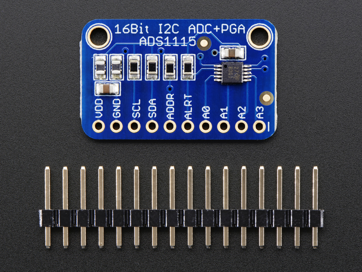

I upgraded my old HX711 modul.
Now I used another one adc converter. ADS1115. 4x single-ended or 2xdifferential inputs.

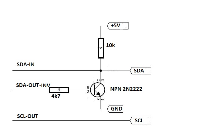

It is possible to used it with parport (2x out pins 1x in pin)
two resistors and one NPN transistor are needed.
All files are included in zip file. ads1115.hal and config file for parport
Martin

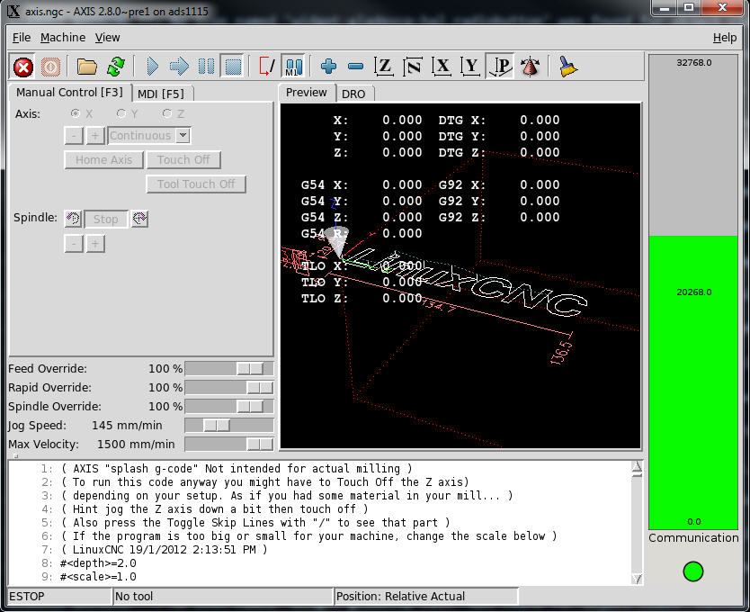

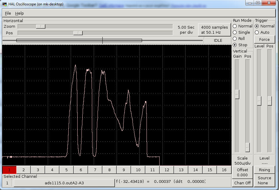

I change output value from raw (0-32767) to +-volts depends on GAIN sets up on [11:9] bits in MSB parrametr.
I tried connect load cell dirrect to ads1115 without any amplifier, and result is good for my purpose. There is 10bits resolutin.
Modul update value every 10ms/channel. It means every 40ms for all 4 configured channels.
I want use this modul in my different project like feadback spindle speed from VFD.
0-10V VFD ->convert 0-5V -> ads1115 -> linuxcnc
Martin

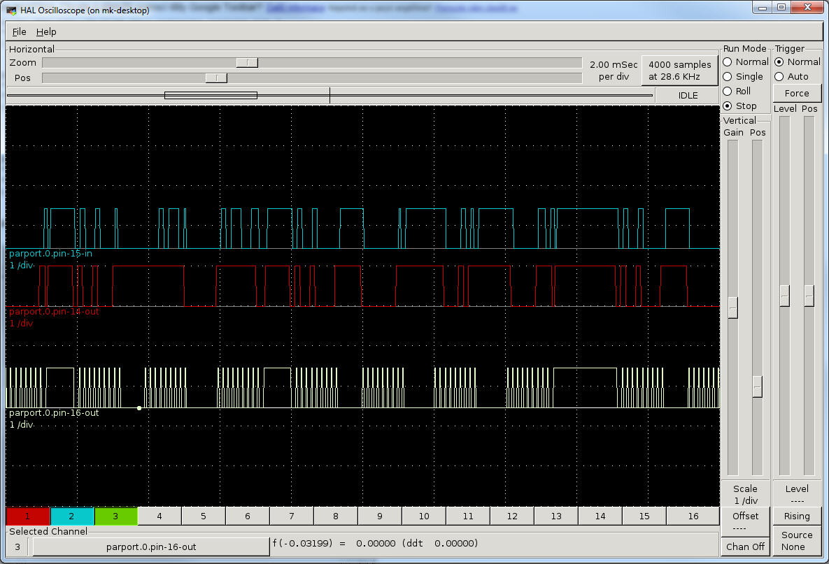

 Communication with ads1115 repeats in cycles:A
 Select input (A0-A3)
 Send i2c address folowed by write bit to ADC
 Send Pointer register for write to Config register (BIT1=0 BIT0=1)
 Send MSB Byte  (default value are generated by cfg string)
 Send LSB Byte
 Send address folowed by write bit to ADC
 Send Pointer register for read Conversion register (BIT1=0 BIT0=0)
 Send i2c address followed by read bit
 Read MSB
 Read LSB
 Go to start with next input
