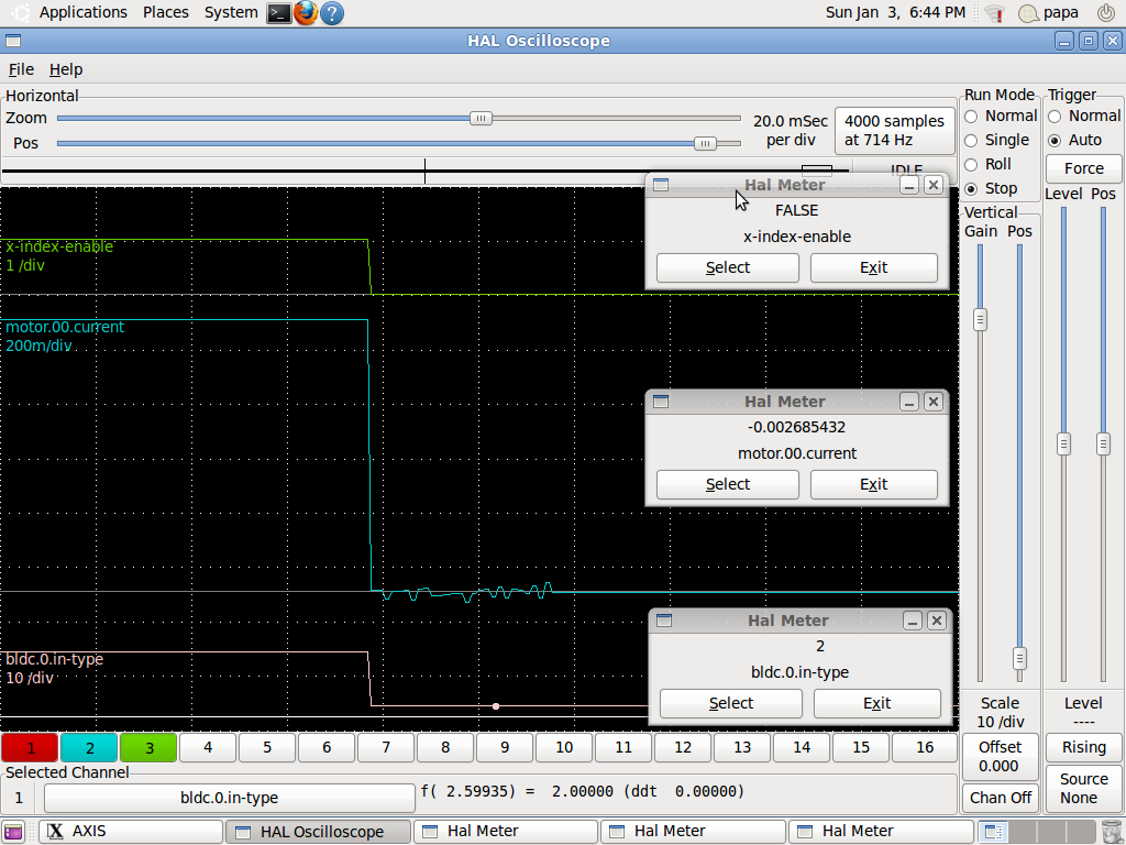

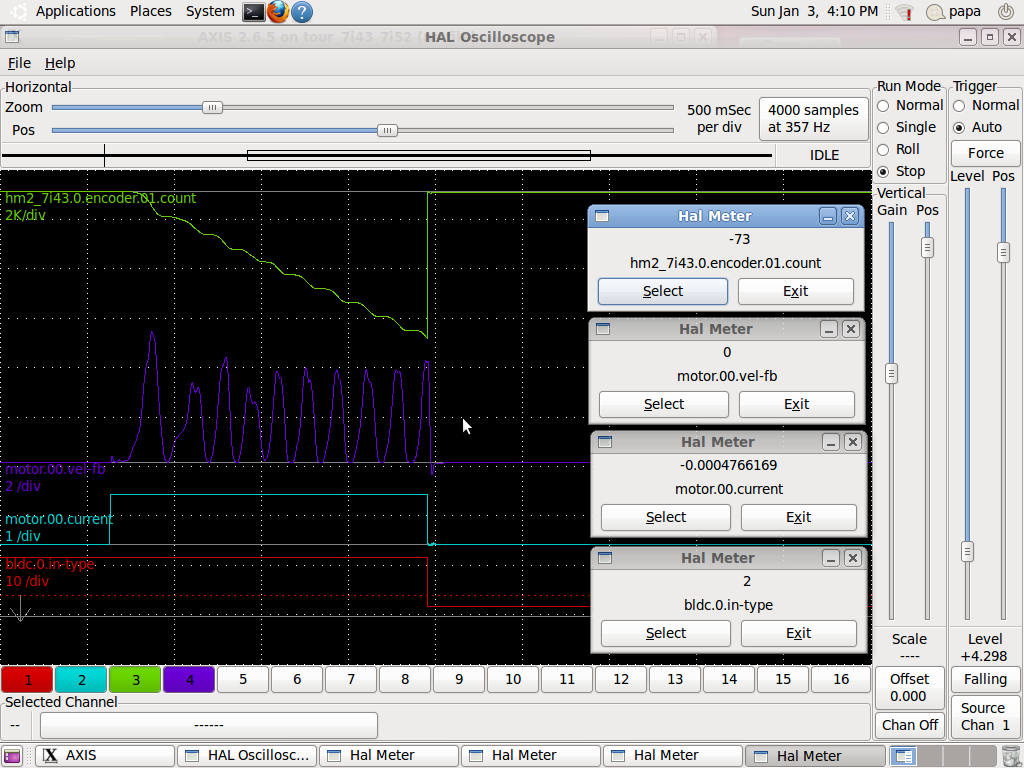

Hello Andy,
So I have the following values for bldc.0.in-type:
* before homing 12
* after homing 2
The motor is unknown, I'm supplying 160V but it could be still underpowered.
I'm attaching the screenshot of halscope
* before homing 12
* after homing 2

03 Jan 2016 16:16 #67784
Replied by andypugh on topic very slow to position a servo motor with 8i20
So, the slow-move and the fast-move variants are both with the in-type at 2?

Hello,
Yes I checked that the value stays at 2 in both situations.

05 Jan 2016 16:09 #67940
If it isn't a change in state of the bldc component and the PID parameters are not being changed then I have no ideas left.

06 Jan 2016 04:41 #67958
Not if it is sometimes fast and sometimes slow.
You need to figure out what is different when it is fast to when it is slow. There must be something.
