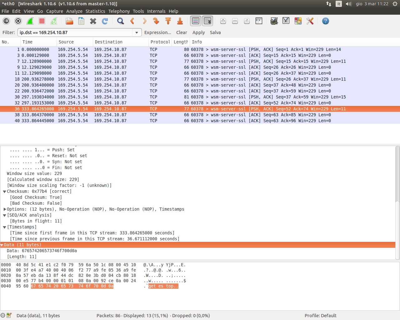

02 Mar 2016 15:18 #70931 by bkt
Replied by bkt on topic linuxcncrsh invalid -i option
I try to connect with qtcpsocket client..... but I've not clear the termination string...... is fifth to send for example...... "set estop on\\r\\n"???
Regards
Giorgio
03 Mar 2016 02:54 #70952 by ArcEye
Replied by ArcEye on topic linuxcncrsh invalid -i option
I am sure it will be quite a simple protocol.
I can recommend Wireshark (used to be called Ethereal) as a packet sniffer.
Used it successfully in the past to reverse engineer an IPCam windoze only IE based interface, so that I could write a Linux Qt based one for it.
Or you may simply be able to connect using something like Cutecom instead of telnet and just switch the display to hex, to see the packet strings in full, including terminations.
regards

03 Mar 2016 04:08 - 03 Mar 2016 11:02 #70956 by bkt
I saw all thanks .... but one thing take rather long to do .... I have to send all commands and get all the answers in order to make a " library" of commands and responses .... I do not think in facts there are many applicants sending and receiving packets ... later place an example for the get estop command ....
the schermata:
Acctually I use qprocess (not in these png file when I use terminal) and "tee" command for to have a clear response file where to read ....
if I can not understand (I not understand ... for shure ArkEye understand very well ... sorry for my first version of post) .... a simple trick to using and codify direct tcp connection (without having to re-implement again the telnet connection .... we would telnetlib or libtelnet for this ...) I can't delete qprocess and use only QTcpSocket ...
sorry for my english junk .... I do not mean to offend you .... i correct the last row of post ....
Regards
Giorgio
