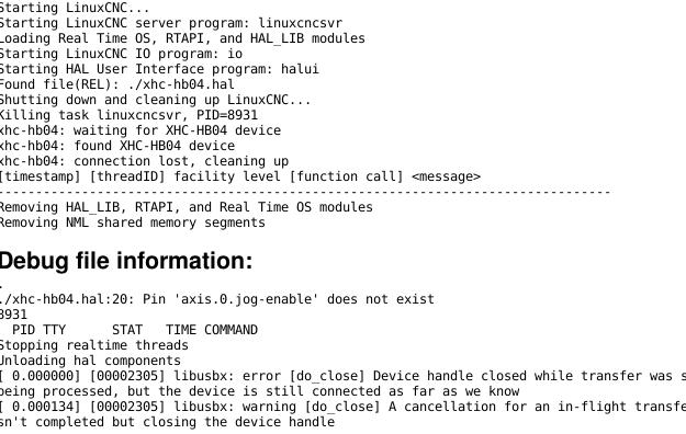

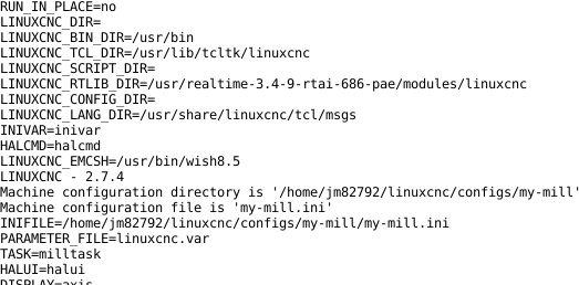

15 Jun 2016 23:34 - 16 Jun 2016 02:27 #76125
by JZHA1985
Replied by JZHA1985 on topic XHC-HB04 Issues.. HAL related
I tried to go the terminal route but after a while I surmised two screenshots may suffice.
It seems post gui didn't work, and my random tinkering didn't cut it. However, the example HAL application works, and I see input on the terminal.. I gave it a whirl on another computer with a fresh install, and other tinkering. I am obviously not experience, but I did spend several hours on it, and have tried to give it my best.
Last edit: 16 Jun 2016 02:27 by JZHA1985.
- Thank you received: 4654
16 Jun 2016 11:25 #76148
Replied by andypugh on topic XHC-HB04 Issues.. HAL related
axis.0.jog-enable is created by motion, and motion will normally be the very first module loaded.
So, it looks like your INI file has the xhc-hb04,hal file loading before the HAL file that loads the motion module.
Put xhc-hb04.hal last in the list. in the in INI file [HAL] section.
