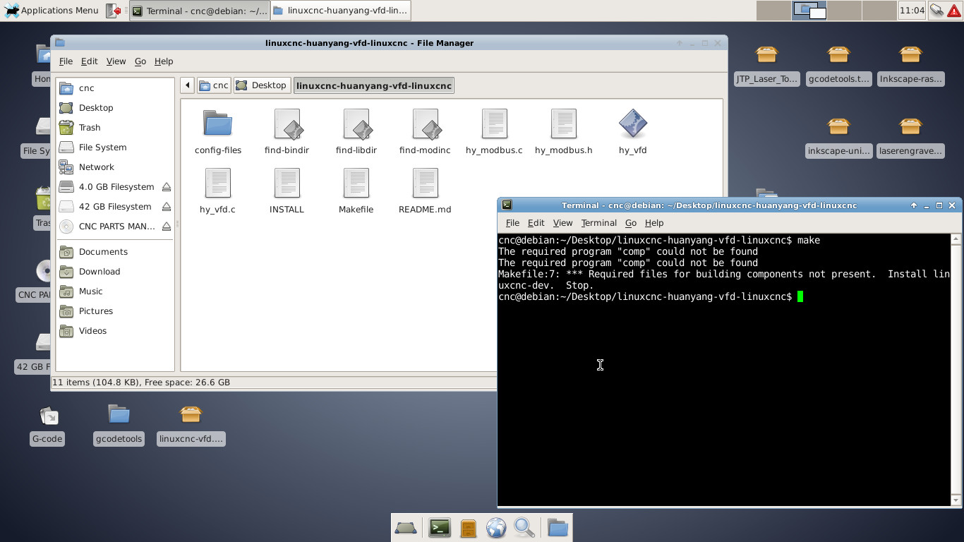

Goodmorning everyone,
I approached recently in the world of linux and the cnc I'm trying to make this "plug-in" github.com/bebro/linuxcnc-huanyang-vfd with linux cnc on Debian but when I go to run the Makefile I get this error,
The required program "comp" could not be found
Makefile:7 : *** Required files for building component not present.
what could be my problem?
Thank you

In the recent versions of LinuxCNC the hal compiler has changed name to "halcompile'. Also
in the recent versions of LinuxCNC the hy_vfd component is built-in, you don't need to compile it.
linuxcnc.org/docs/2.7/html/man/man1/hy_vfd.1.html
Just add it to your HAL file and run the spindle.

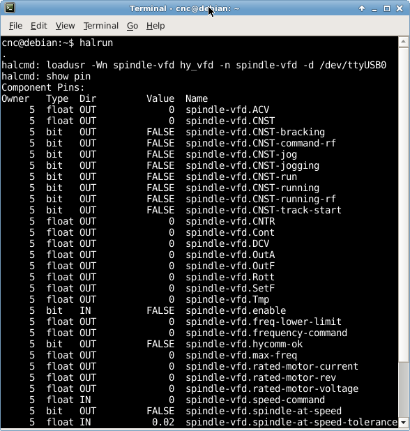

- Posts: 19888
- Thank you received: 4646
09 Jul 2016 11:08 #77214
This might ned to be something like
So that the system knows where the modbus dongle is connected.
(basically do ls /dev/tty*, then plug in the dongle, then repeat the ls /dev/tty* and see what the new one is called)
You might have to edit-out some conflicts if the motion.spindle-xxxx pins are already connected in the HAL.
Replied by andypugh on topic Huanyang vfd Plug-in
loadusr -Wn spindle-vfd hy_vfd -n spindle-vfd
loadusr -Wn spindle-vfd hy_vfd -n spindle-vfd -d /dev/ttyUSB0(basically do ls /dev/tty*, then plug in the dongle, then repeat the ls /dev/tty* and see what the new one is called)

Try a trial run, without the rest of LinuxCNC. Open a terminal window and type:
And see what output you get. If it gives no error, then typeand you will get a list of the vfd pins.
halrun
loadusr -Wn spindle-vfd hy_vfd -n spindle-vfd -d /dev/ttyUSB0And see what output you get. If it gives no error, then type
show pinPlease Log in or Create an account to join the conversation.

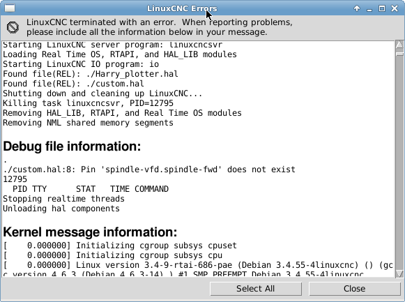

09 Jul 2016 17:00 #77228
You seem to have spindle-vfd.spindle-fwd but the pin name is spindle-vfd.spindle-forward

then , making a small summary ... the files needed for communication between my LinuxCNC and vfd via RS485 there I've got it .
in my hal I glued those lines that you said
My spindle is called " spindle- vfd.spindle -forward "
But I keep getting that error when I start my configuration !
What should I try again ?
