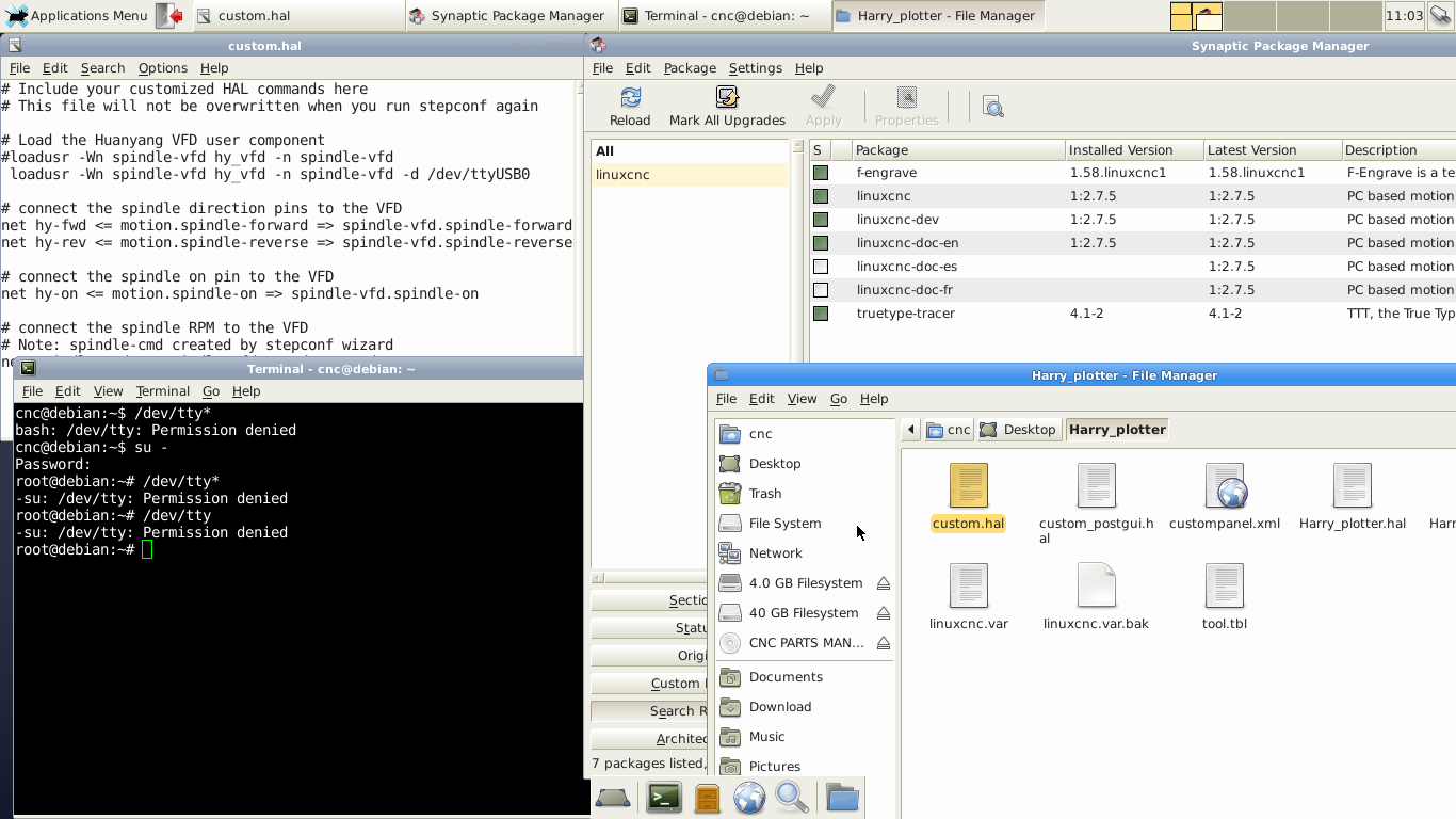

I tried to re-edit my custom.hal continues to give me back error ,
./custom.hal:6 : waitpid failed ht_vfd spindle- vfd
./custom.hal:6 : hy_vfd exited without becoming ready
more I can not access my tty !!!

I am not sure that you would expect to be able to do anything simply by typing /dev/tty
ls /dev/tty*
Should list the devices.
If you are running from a USB or DVD then you probably won't have the required access to the tty.
ls /dev/tty*

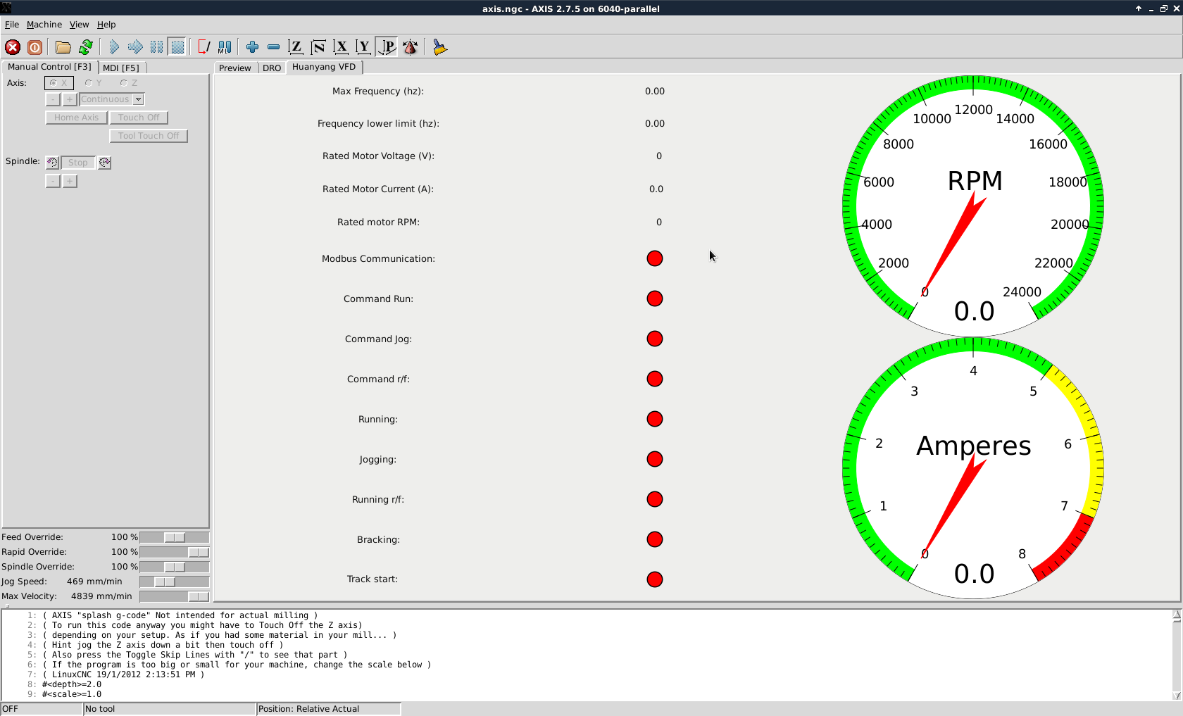

I have made a custom gladevcp panel for huanyang vfd.
Just put these files to your config folder
edit custom.hal this lineand put these settings to your vfd.
Also edit your machine ini file and add these lines in [DISPLAY] section
Your [HAL] section in you machine ini file must have
last add your user to dialout group (to allow access usb_to_rs485 for your user account)
from terminal give the command
