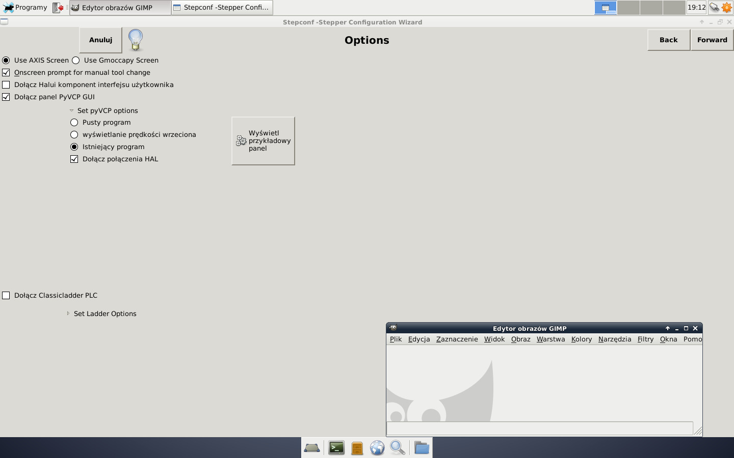

05 Feb 2020 21:20 - 05 Feb 2020 21:28 #156606
by jarcysgru
Replied by jarcysgru on topic is there driver for the new XHC-WHB04B-4
Hello, I started XHC-WHB04B-4 I tested working but I had to install Linuxcnc 2.9 on Debian 7
Gives the link and my poor quality video
www.cnc.info.pl/mpg-linuxcnc-2-9-usb-cnc...dant-t103332-60.html
www.machmaker.pl/1_10_5_instrukcja-insta...stemie-debian-7.html
Now I have a problem how to set the huanyang spindle control via RS-485 in Linuxcnc 2.9 and that's because I don't know how to mark in the configuration card that has changed take it.
I had running spindle control according to this guide on Linuxcnc 2.7.14 and it was OK

06 Feb 2020 22:32 #156660
by jarcysgru
This is my mistake with Huanyang RS-485.
Debug file information:
./custom.hal:8: Pin 'motion.spindle-forward' does not exist
custom.hal
loadusr -Wn vfd hy_vfd -n vfd -d /dev/ttyUSB0 -p none -r 9600
net spindle-cmd-rpm-abs => vfd.speed-command
net spindle-cw motion.spindle-forward => vfd.spindle-forward
net spindle-ccw motion.spindle-reverse => vfd.spindle-reverse
net on motion.spindle-on => vfd.spindle-on
custom_postgui.hal
net spindle-cmd-rpm-abs => pyvcp.spindle-speed
net spindle-at-speed => pyvcp.spindle-at-speed-led
net spindle-at-speed => vfd.spindle-at-speed
setp vfd.enable 1
custom.hal
custom_postgui.hal
setp vfd.enable 1
