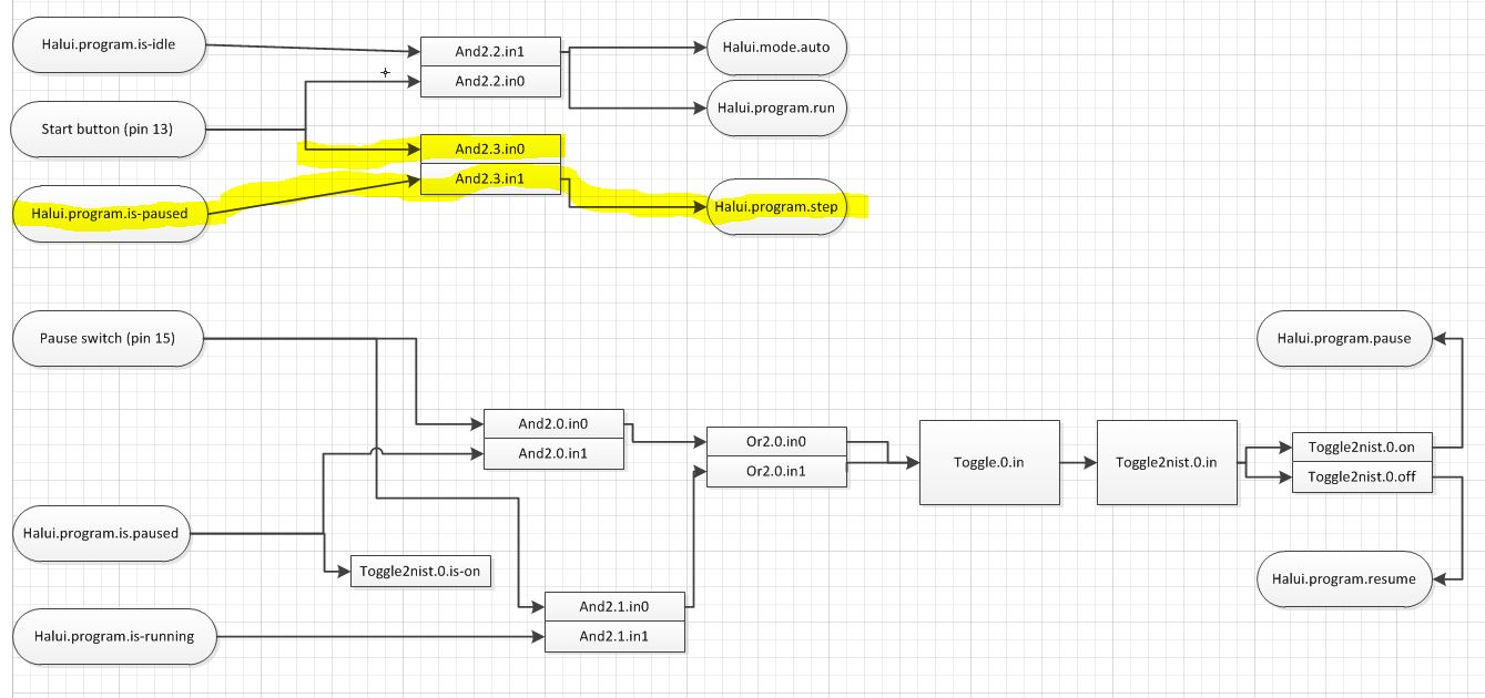

- SenorAguas

When I follow the map, it seems like it should work. Maybe I screwed up the map?
It will start with the run switch, but only run 1 step. The pause switch will get it going again.
Here's the modified code:

- SenorAguas

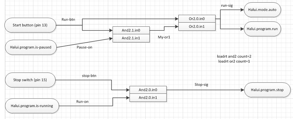

17 Nov 2016 20:42 - 17 Nov 2016 20:48 #82926
by SenorAguas
Replied by SenorAguas on topic physical start button + pause switch
OK, I have it 95% working with the following code, which has gone through about 15 iterations now and is much much different than where I started. The machine is physically doing what I want with the two buttons, but I'm getting error messages whenever hitting the stop switch (which used to be a pause switch). I'm really not sure the difference between pause and stop, but changing it to stop allowed me to restart using the start button.
This is the error: can't do that (EMC_TRAJ_SET_TELEOP_ENABLE) in auto mode with the interpreter idle.
Can someone help me get rid of this error?
Here's the code:
Here's the code:

- Todd Zuercher
- Online
- Posts: 4787
- Thank you received: 1477
17 Nov 2016 20:57 - 17 Nov 2016 21:02 #82929
Replied by Todd Zuercher on topic physical start button + pause switch
I haven't been following this really closely, but perhaps you are making this more complicated than it needs to be. What happens if you follow the kiss method and do this?You may also want to try it with and with out the halui.mode.auto connection.
net run-btn <= parport.0.pin-13-in => halui.mode.auto => halui.program.run

- SenorAguas
- Posts: 32
17 Nov 2016 22:45 #82935
by SenorAguas
Just tried it with and without the auto part of it. It basically worked the same as what I've already got, i.e. it basically did what I wanted it to do, but with an error on the screen:

18 Nov 2016 03:30 #82945
This is a longshot, but you could try this
But I'm not sure this is the real source of the problem. I'll try a few things in a simulation tomorrow.
net run-btn <= parport.0.pin-13-in => halui.mode.teleop => halui.mode.auto => halui.program.run
net stop-btn <= parport.0.pin-15-in => halui.program.stopBut I'm not sure this is the real source of the problem. I'll try a few things in a simulation tomorrow.

18 Nov 2016 15:51 - 18 Nov 2016 16:04 #82964
This doesn't give the alarm, but I don't think it should be necessary on a Cartesian machine that doesn't have a joint mode. (seems a little bug like to me.)
The more complecated examples you were grabbing code from (with all the ands, ors...) I believe were trying to make one button do multiple tasks. Such as one button that pressing it when the machine is idle starts a file, press again pauses it, and press again resumes. Which is perfectly fine, just a little harder to configure, getting all the logic and hal commands right. At least this might get you started with something that works.
setp halui.mode.teleop 1
net stop-btn <= parport.0.pin-15-in => halui.program.stopThe more complecated examples you were grabbing code from (with all the ands, ors...) I believe were trying to make one button do multiple tasks. Such as one button that pressing it when the machine is idle starts a file, press again pauses it, and press again resumes. Which is perfectly fine, just a little harder to configure, getting all the logic and hal commands right. At least this might get you started with something that works.
