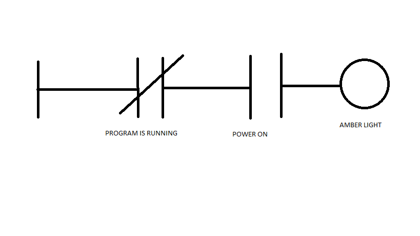

I have 3 warning lights on my Mesa 7i76e. I want them to act as follows.
1. When in Estop, red light turns on, all other lights off.
2. When power button is pressed (eg in Axis GUI), Amber light comes on signifying its idle
3. When running gcode, I want the amber light to go off and the green light to come on to say its making money!
And if it was at all possible
4. When program is paused, one of the lights (green or amber, prefer green) to flash.
So the red light is easy to do (iocontrol.0.user-enable-out), the green light is easy to do (halui.program.is-running). I've currently got amber working quite well on motion.motion-enabled but I can't turn it out when a program is running in HAL. I figured if I got desperate I could use a relay triggered by the green light output to drop power to the amber light. I thought I should be able to use some logic statements but after wasting hours, I gave up as I kept ending up where I started.
I can generate a flashing light with
Signal just needs a couple of conversions to get back to a bit.
The reason I want to do this is I've used some machines with a light mast on them with red, green and amber lights and they were so good as you could see at a glance across the room what was going on so I wanted to replicate that on my machine. It is confusing when green and amber come on together as traffic lights don't do that!
Any ideas would be appreciated.

06 Jan 2017 12:55 - 06 Jan 2017 13:11 #85335
by bevins
Replied by bevins on topic Machine warning lights (Red, Amber, Green)
One rung in classic ladder should do the trick.
Program is running -not contact in series with the power button contact =====> amber light
So when the power is on the amber light is on when it runs a program, the contact shuts it off.
However when the program finishes, the Amber light should turn back on.

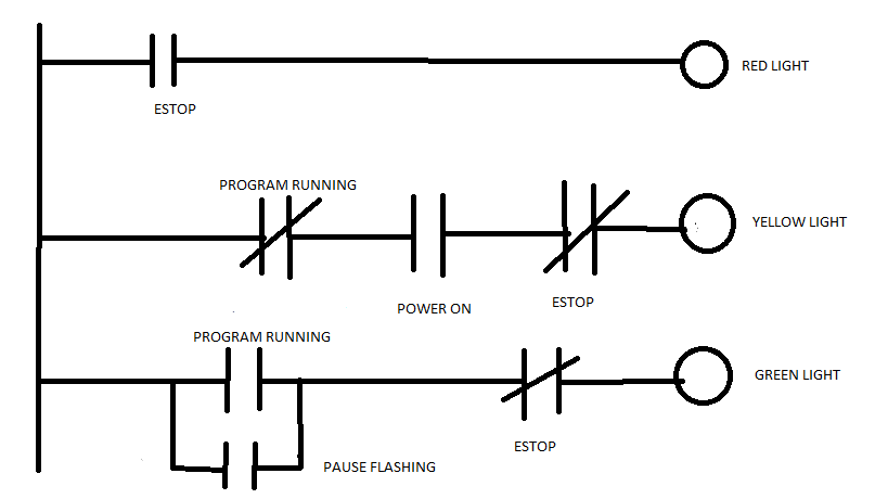

06 Jan 2017 13:37 - 06 Jan 2017 13:52 #85336
by bevins
Last edit: 06 Jan 2017 13:52 by bevins.

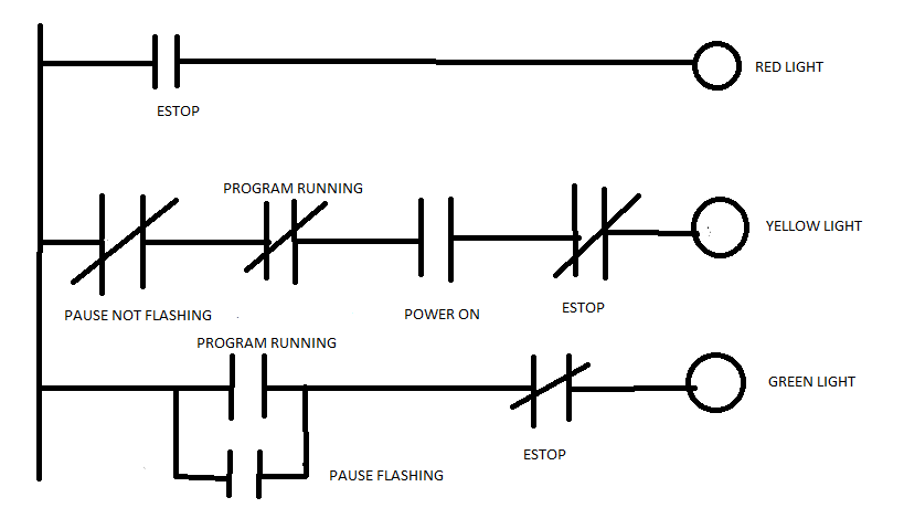

06 Jan 2017 13:44 - 06 Jan 2017 14:43 #85338
by bevins
The only thing I dont know is when the program is running and you hit pause, I dont know if "program running" goes false. If it doesnt, then the flashing contact should be a NOT and goes in series instead of parrallel.
/EDIT - If the Program running switches state when the pause is true then the yellow light may turn on while the green light is flashing. If this behaviour is not ideal for you then a pause(not flashing) contact NOT should be placed in series with the amber light rung like the image shows below.
Last edit: 06 Jan 2017 14:43 by bevins.

06 Jan 2017 13:49 #85339
by bevins
I like this idea. I may have to do this on my ongoing retrofit....
