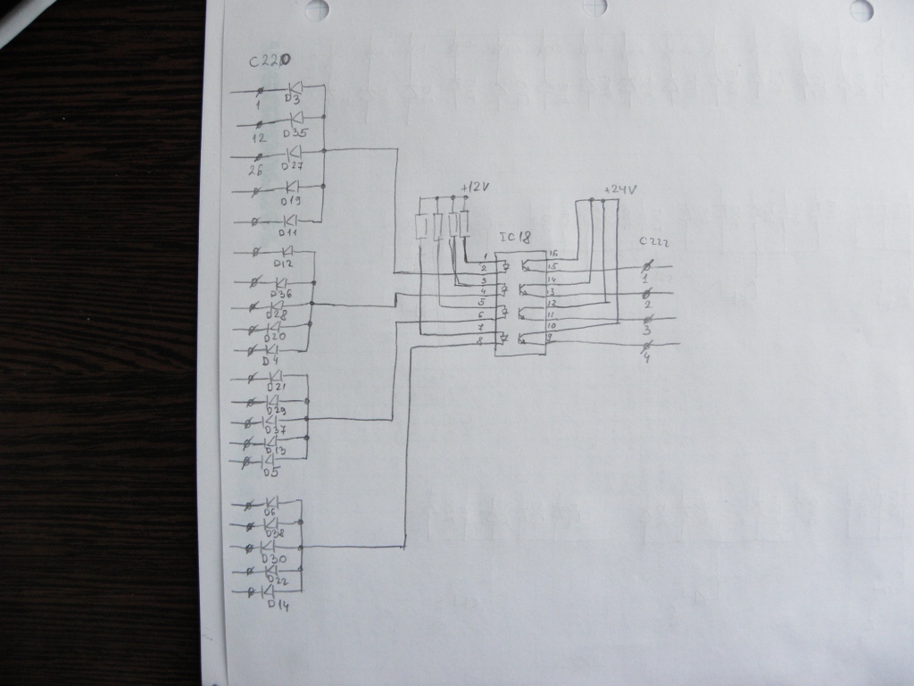

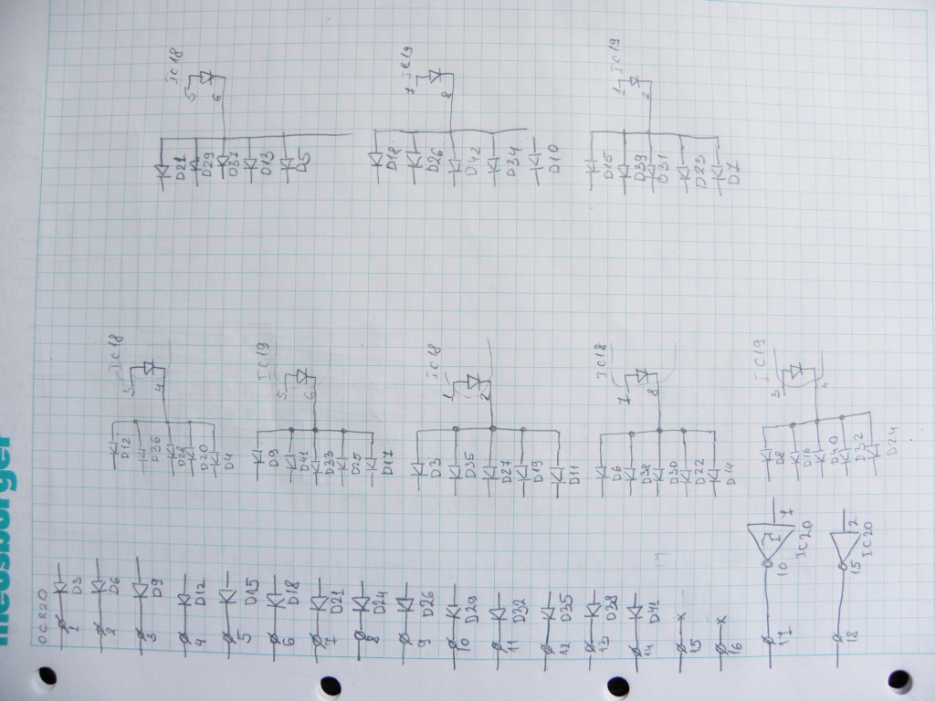

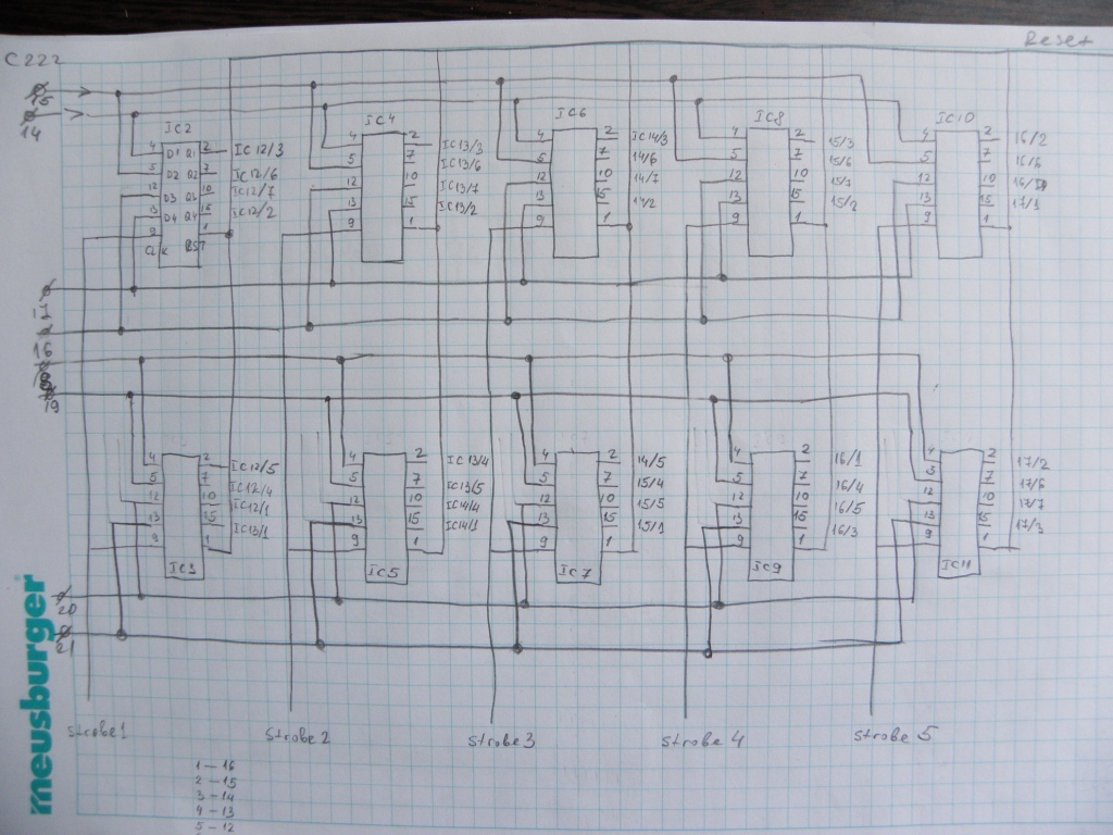

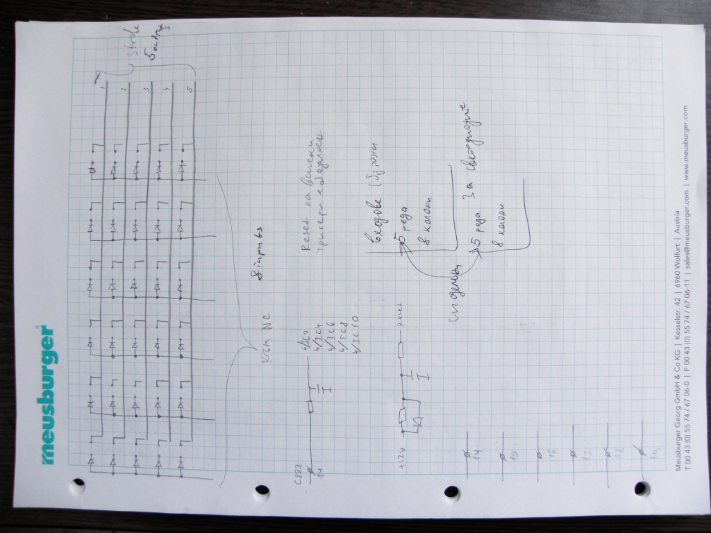

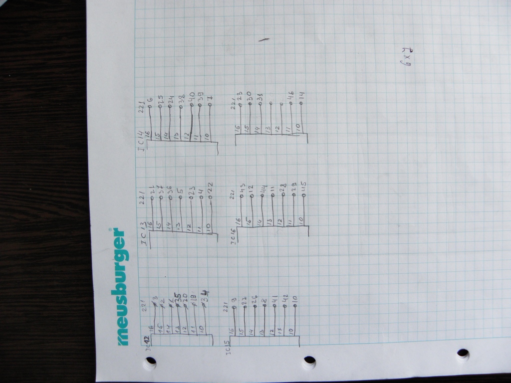

19 Feb 2017 10:04 - 20 Feb 2017 20:14 #88242
by Niko
Replied by Niko on topic Question about matrix_kb
[This is to give an idea of the original mori circuit board .
The output side uses D triggers as a one bit memory . At the time I didn't write down the IC numbers but the circuit speaks for itself .
For now it seems to work well with matrix_kb . I moved the selector switches to direct inputs and run it in a 4ms thread . Response is good .
Cheers
Nikolai
Cheers
Nikolai
Last edit: 20 Feb 2017 20:14 by Niko.

19 Feb 2017 20:52 #88296
by sinusvag
Replied by sinusvag on topic Question about matrix_kb
I think there's something wrong with the permissions for the photos - I just get "You do not have permissions to access this page" instead of pics!
Cheers!
Cheers!
- sinusvag
- Posts: 9
21 Feb 2017 20:42 #88460
by sinusvag
Super, there they were! (The pics)
Thanks!
Thanks!
