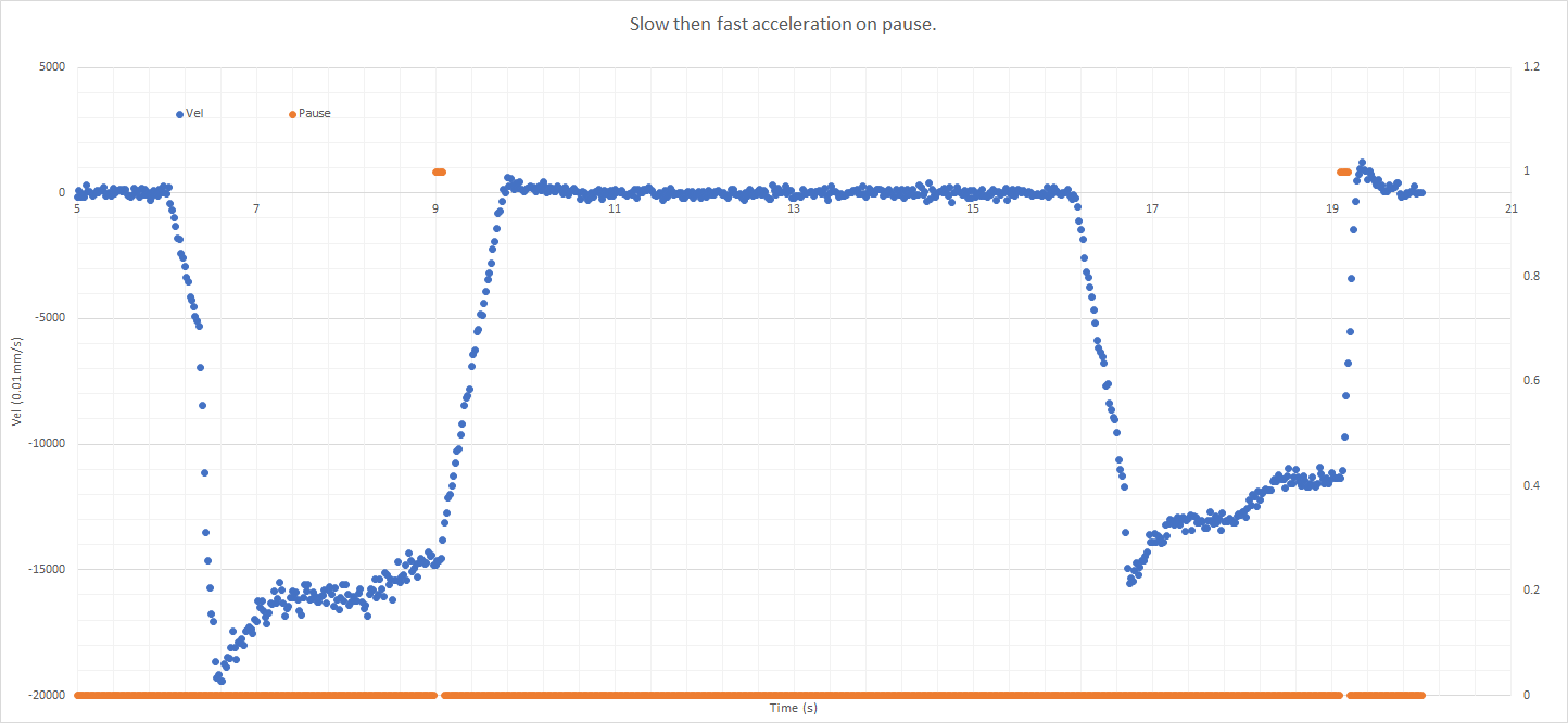

was wondering if it was possible to adapt the maximum acceleration of the motion while running a ngc file.
More precisely I would like to increase the acceleration to a higher value when I pause in order to stop the motion more quickly. Then when I resume would like to use the default acceleration to have a smooth start motion.
Is such a thing possible? I have been trying to change the hal pin ini.0.max_acceleration and or ini.x.max_acceleration values. If I change them while running the file, nothing happens and it carries on with the initial acceleration when the file was started. If I change it just before the program.pause is activated or at the same time, again it does not change anything.
I guess the trajectory planner interpreter cannot really change on the go the acceleration and recompute the new trajectory so might not be possible.

Correct -- ini hal pins are handled by the milltask module and changed
values are accepted only when there is no motion.

So would a new value be accepted and taken into account at a moment where there is no motion on the file?

no -- values are sampled only when a program (or mdi command or jogging move) is not runningSo would a new value be accepted and taken into account at a moment where there is no motion on the file?

Being investigating the different possibilities, I still have some questions related to some weird behavior observed:
-when pausing which max_acceleration value is supposed to be used? The axis ini.x.max_acceleration or joint ini.0.max_acceleration max acceleration? In my opinion as I am homed it should be the axis one but not sure, see the second point:
-was trying to change the hal value of ini.x.max_acceleration when the pause was triggered to a higher value during 0.8s to force the pause with a higher acceleration at the begining. It seems that doing a serie of pause/resume generates a random behavior presenting either a fast pause with high acceleration or a slow pause with low acceleration. Is it possible that the value get updated on a pause once the machine motion is stopped. Which could explain that for the next resume and the next stop the acceleration is different. Or is it a random behavior wether the pause either consider the axis or joint max acceleration which can be different? I attached some halscope log curves about the velocity (blue with Y on left axis) where we can see the slow pause first and the fast pause in second triggered by the orange signal (binary right axis).The first acceleration is about 200 mm/s2 and the second one about 690mm/s2 which does not correspond also to any parameter of my ini file. Those two pauses are done within the same ngc file.
Nico
