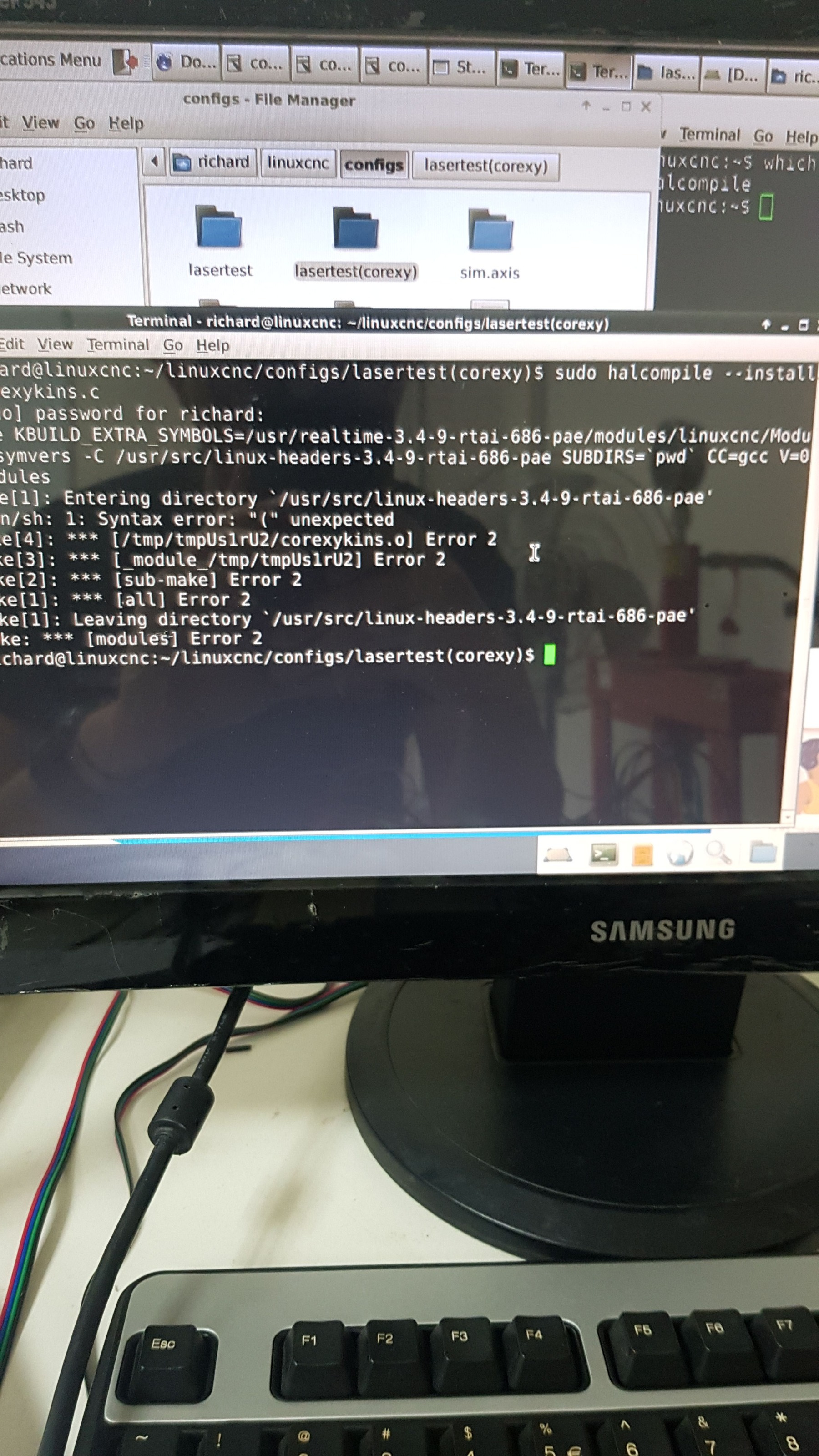

Hello, I was trying to do the sudo halcompile --install corexykins.c in my linuxcnc configuration folder which I made with step conf. But after doing that step, I get this message.
Fyi = I am running a live version of the Debian Wheezy with linuxcnc 2.7 and rtai kernel. I wasn't able to download some repo and linuxcnc -dev, but then I change the sources of my debian wheezy to archive, and my buildbot linuxcnc to become buildbot linuxcnc with master-rtpreempt.
16 Apr 2019 04:33 #130963
Replied by andypugh on topic install new kinematics module
That appears to be a problem in the .c file, other than that it looks like halcompile is all installed and working.

Actually I took this corexykins.c from the internet as a sample, so I haven't done anything with this file. I've already included the loadrt corexykins in the .hal file. May I upload the code here so that you can do a little inspection and teach me sir?
