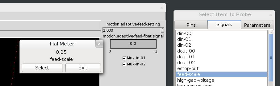

Thank you andypugh for giving attention to our post.
No error messages whatsoever, MUX4, MUX8 and the bar in PYVCP all working fine.
We are talking Wire EDM.
When eroding the gap voltage between the wire and the workpiece is inverse proportional towards the distance between both.
I mean, when erosion takes place, the nearer the wire gets to the workpiece, the lower the generator voltage becomes.
We detect this voltage in a "gap detector" an put out a 3 bit signal over an IO board towards HAL.
This detection goes through MUX8 and gives an adaptive feed to the wire.
This is what the creator of the motion.adaptive-feed meant in creating this pin.
So far, so good.
Our handicap, at this moment, is that the decision making of the gap detector is that fast, that it is difficult to follow with the eye.
A visualisation bar in PYVCP would help a lot. The equivalent is present in all Wire EDM's like AGIE, Charmilles and GF+.
This bar helps the operator in the decision making to hold or change the generator settings.
In LinuxCNC terms:
by using MUX8 we occupy the hal pin motion.adaptive-feed. Once used, it can't be used once again to visualise a bar in PYVCP.
One way out, would probably be to use the inverse pins of our IO board ;to use a separate MUX8 and channel this to the visualisation bar.
Any help greatly appreciated.

11 Oct 2017 10:38 #100200
If you have a line in HAL like
net signalname mux8.0.out motion.adaptive-feed-in
Then you can connect the PyVCP bar to the same signal:
net signalname pyvcp.motion-adaptive-feed-float
A pin can only connect to one signal, but any number of pins can connect to the same signal.

11 Oct 2017 13:02 #100204
by ghislain.vdwalle
Replied by ghislain.vdwalle on topic motion.adaptive-feed
Hello Andypugh,
thank you very much for the help. This works indeed.
For the sake of being complete: In the attachments you will find a copy of the XML file, an extract of the custom_postgui.hal file
As proof you can watch the workings on:https://youtu.be/95cdyaj2RBM

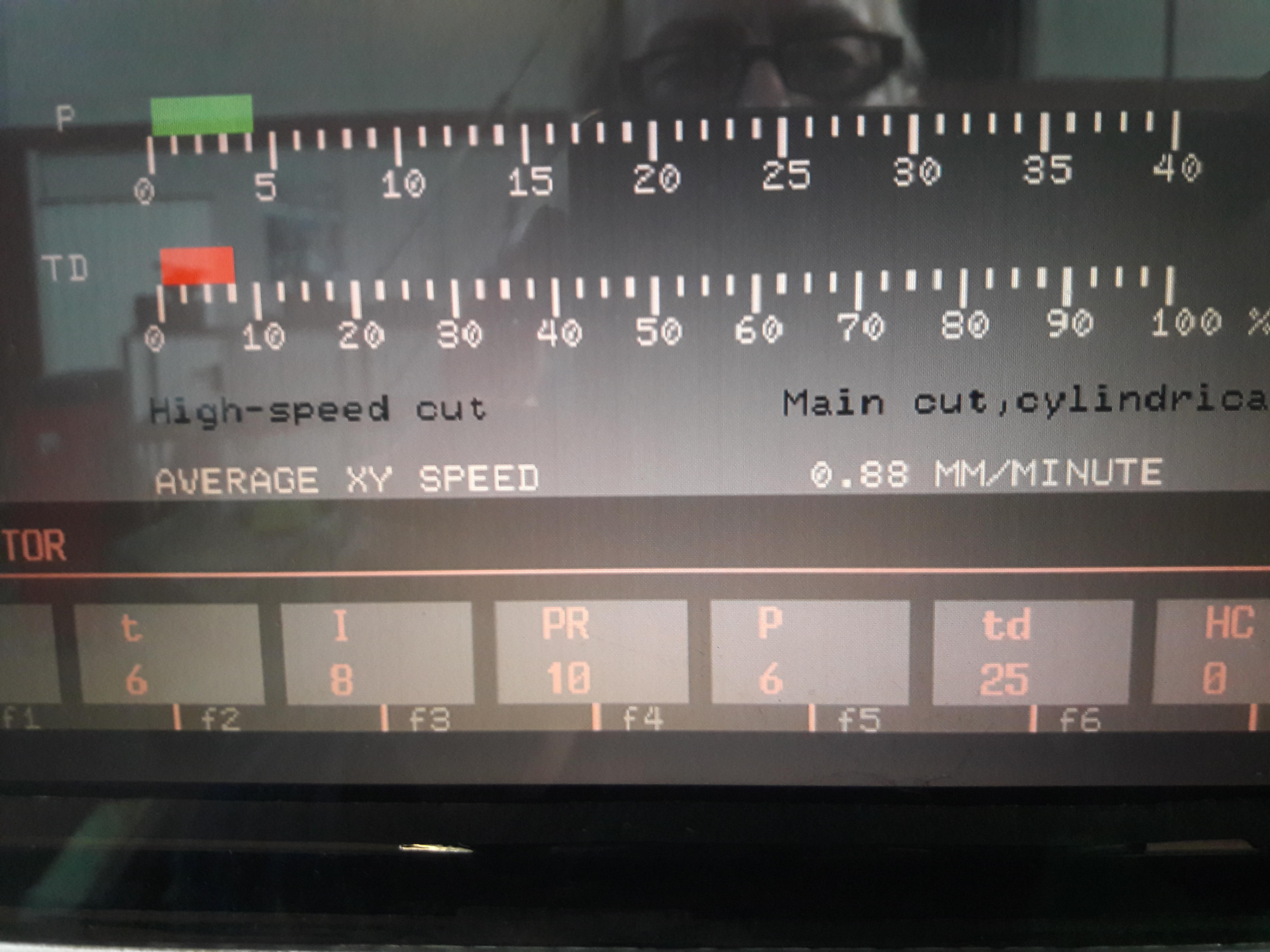

14 Oct 2017 08:57 #100344
by ghislain.vdwalle
Hello Andypugh,
I have a question, motion.adaptive-feed related.
On our AGIE wire EDM we have beside the generator indicators and progressions bars an indication in mm/min how fast the wire progressed in the workpiece, updated every 5 seconds.
Just looking at the workpiece being eroded, the operator never can judge about the real progress the wire makes.
Visually a progress of 0.15mm/min is nothing different as a progress of 1.15mm/min.
Using this indicator, we adapt pulse voltage, pulse width, frequency and duty factor in the generator.
I have added a picture of the screen of the Agie in the attachment.
Talking LinuxCNC, how can this be built? Should I ask the programmers for it, or is it possible to use HAL and PYVCP or GladeVCP?
kind regards,
