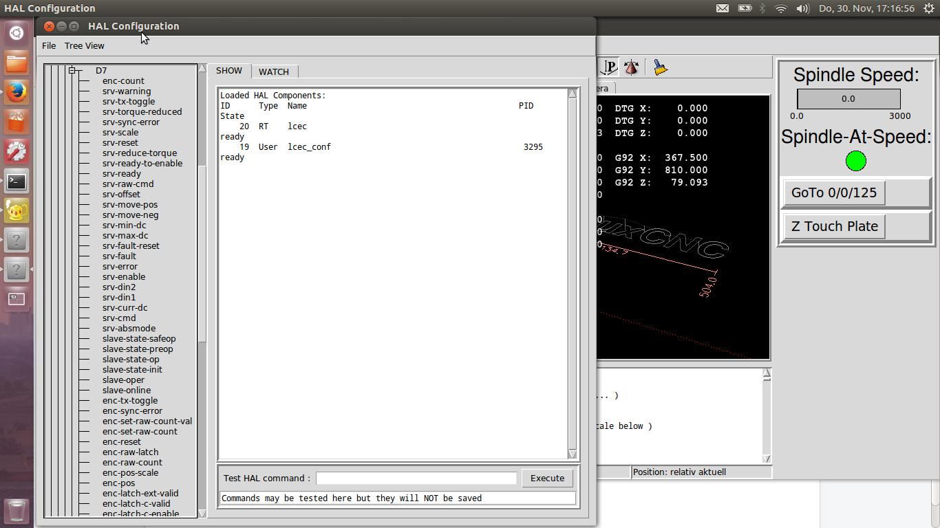

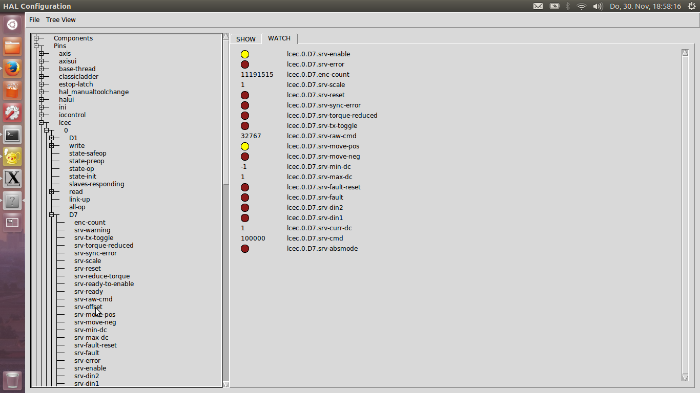

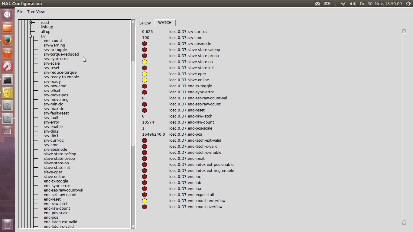

30 Nov 2017 16:19 - 30 Nov 2017 18:12 #102541
by Hawkeye
Replied by Hawkeye on topic Ethercat HAL configuration for Beckhoff EL7041 without encoder
Hello db1981,
looks like there is no velocity attribute available inside my lcec.0.D7. (this is EL7041-0000).
Did I miss something?
I had a closer look at some of the values of lcec.0.D7...
Looks like the encoder is jumping arround although there isn't something connected to it and motor is standing still.
Big Question is now, where is the problem?
I dont' get any voltage at the motor connectors.
50V and 24V are properly connected.
This is driving me crazy!!
If this thing won't start to run, it will hit the bottom of my trash bin very hard!!
This was a total waste of energy so far.
If someone is looking for me, I am in front of my rittal cabinet putting some wires into it..

30 Nov 2017 18:59 - 30 Nov 2017 19:00 #102542
by Allan
Replied by Allan on topic Ethercat HAL configuration for Beckhoff EL7041 without encoder
Hello Hawkeye
Following on from the db1981 to drive your motor from the terminal
below are a number of commands you might find helpful.
In particular you could try starting LinuxCNC and then trying the
command to enable the servo followed by drive the motor.
Allan

List servo faults:
halcmd show pin | grep srv | grep fau
Return 20 bit OUT FALSE lcec.0.D7.srv-fault
20 bit IN FALSE lcec.0.D7.srv-fault-reset:
Enable Servo:
halcmd setp lcec.0.D7.srv-enable 1
Return: NONE
Comment: Hardware LED for MOVE_CW and ENABLE are now active. When setting to "0", both getting dark.
Read Maximum Motor Current (mA)
ethercat upload -p 6 -t uint16 0x8010 0x01
Return: 0x1388 5000
Drive Motor
halcmd setp lcec.0.D7.srv-cmd 0.5
Return: NONE
Read Microstepping Setting from Driver
sudo ethercat upload -p 6 -t uint8 0x8012 0x45
Return: SDO transfer aborted with code 0x06090011: Subindex does not exist
please see below:
Reset Terminal to its Factory Settings
sudo ethercat -p 6 download --type uint32 0x1011 0x01 0x64616F6C
Return: NONE
Read Motor Current Settings
ethercat -p 6 upload --type uint16 0x8010 0x01
Return: 0x1388 5000
Comment: 2,5A Motor. (I dont care even if it would be killed!)
Read Motor Supply Voltage [mV]
ethercat -p 6 upload --type uint16 0x8010 0x03
Return: 0xc350 50000
Comment: Powersupply is 48V
With LinuxCNC running (and HAL started)
HAL commands can be run from the command
line:
List the pins using:
halcmd show pin

List servo faults:
Enable Servo:
Return: NONE
Return: 0x1388 5000
Drive Motor
Return: NONE
