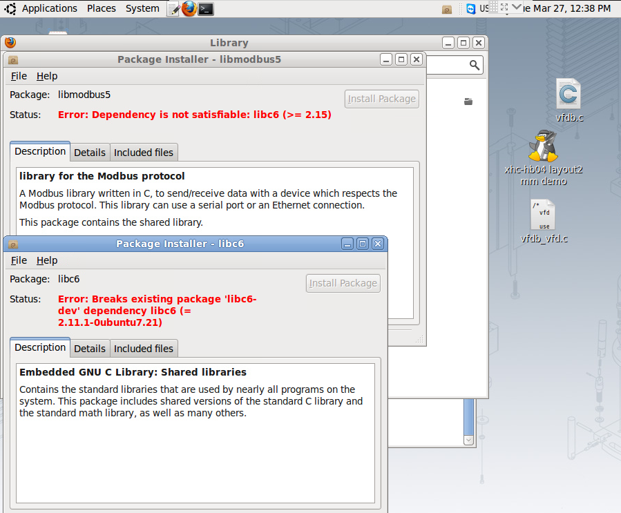

I found other way to compile is:
github.com/KurtJacobson/RF45-CNC/wiki/Bu...LinuxCNC-From-Source
but now i'm stuck on:
i've download libmodbus-dev package from other source. It require libmodbus5, and libc6 version >2.15 .
But noway to update libc6 on ubuntu 10.04
operator@tormachpcnc:~$ cd linuxcnc-dev/
operator@tormachpcnc:~/linuxcnc-dev$ dpkg-checkbuilddepsdpkg-checkbuilddeps: Unmet build dependencies: libmodbus-dev (>= 3.0)
operator@tormachpcnc:~/linuxcnc-dev$ sudo apt-get install libmodbus-dev
Reading package lists... Done
Building dependency tree
Reading state information... Done
E: Couldn't find package libmodbus-dev
operator@tormachpcnc:~/linuxcnc-dev$ i've download libmodbus-dev package from other source. It require libmodbus5, and libc6 version >2.15 .
Last edit: 27 Mar 2018 17:43 by emptyhb.

I think you are using the Tormach version of LinuxCNC?
I think that they have a beta version of their software on a newer Linux and including the Joints-axes stuff.
Might be worth a try.
