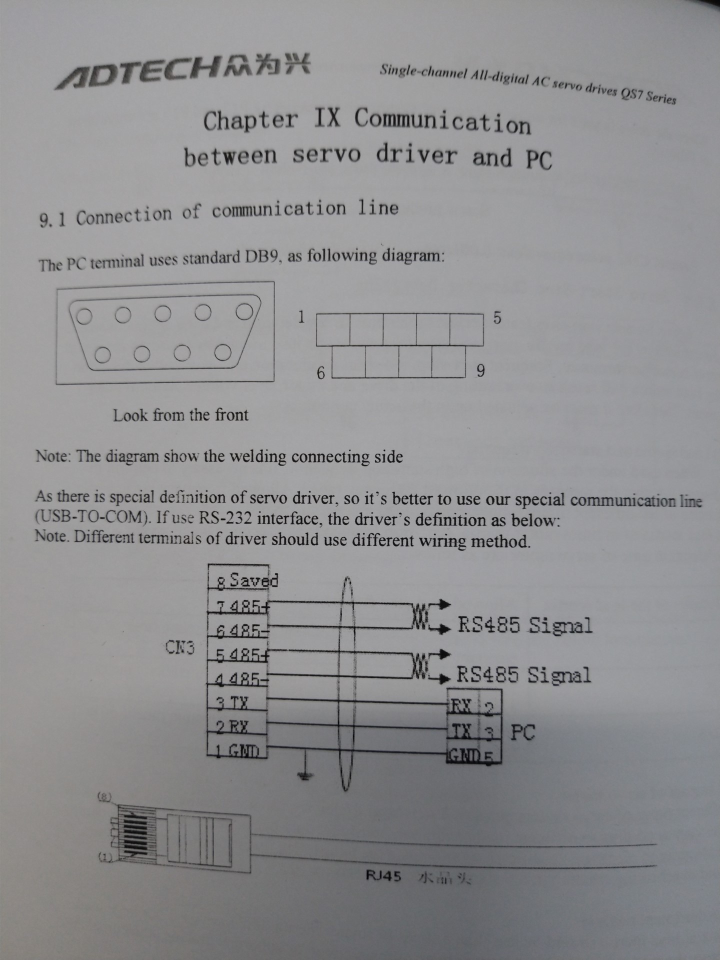

I tried your solution and I can now see the pins using the halcmd show pin command but looking at the terminal where I loaded the file I see the following transaction failure message
I think that maybe I have done the wiring incorrectly as the manual is a little confusing.

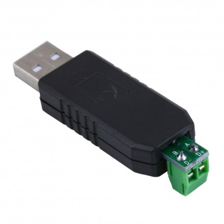

I have set the communication type parameter on the drive to operate in RS-485 and I set the same baud rate as in my configuration file.
The USB-RS-485 adapter I got is just a 2 wire same as the one on the picture below
I connected pins 4 and 6 to B(D-) terminal and the pins 5 and 7 to A(D+) terminal. I left all the remaining RJ45 wires disconnected.
Is this the correct way to wire or did I make a mistake there?

17 Jul 2018 13:09 #114380
Replied by andypugh on topic Problem with MB2HAL configuration
I think that you probably only need to connect to one of the RS485 pins. (But you might well find that both D+ and D- pins are internally connected and are duplicated only to allow daisy-chaining)
You might need to connect the GND to the same GND as the controlling PC.

Thank you. I have the wiring problem solved now. The PC is now communicating with the drive.
