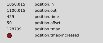

If you want to experiment you can try this module i wrote in 5 minutes : position.comp
To install it copy into directory src / hal / components and then open terminal and type: sudo halcompile --install position.comp
Check the output file in : /usr/lib/linuxcnc/modules/ the name there will be position.so
If you have run in place, copy the position.so file also into your run in place version path : rtlib
To test you can set variable with halcommand : setp offset 50.
I will try this also if it works tommorrow, this code is not tested, compiling was okey !!
in your postgui.hal file : loadrt position.comp

@Hi Tommy,
It works. I forgot to make the component coupled to a timer. I was searching some time before i knew the qlue...
So now you know how to make your own thc function. Add some stuff to it and give it a go !!
In custom postgui.hal :
loadrt position
addf position servo-thread
It is recommended to make your z axis signals in the same file, i used the postgui file for this.
Okey motor z-axis is tested today. Here the motor connections to extract the offset :
so if we set the offset parameter in halshow with : setp position.offset 5
The motor is turning 5mm, and the screen dro is still the same. The offset is working !!
loadrt position
net 1 joint.3.motor-pos-cmd position.in
net 2 position.out stepgen.3.position-cmd
net 3 stepgen.3.position-fb => joint.3.motor-pos-fbso if we set the offset parameter in halshow with : setp position.offset 5
Last edit: 26 Jul 2018 13:36 by Grotius.

26 Jul 2018 15:21 #114895
by Grotius
Replied by Grotius on topic Toma/Proma HAL for Mesa Board -Basics
Hi this code works very smooth on proma thc, the thc speed is about 10% during testing with motors.
I will try to adapt a 0-100% speed and auto configure this speed on 35% wich is perfect.
component position "offset control between commanded position and postion feedback";
description
Postgui.hal connections
author "Grotius CNC Machines";
license "GPLv2 or greater";
option singleton yes;
// Input Pins
pin in float in "input value connected to joint.3.motor-pos-cmd";
pin in bit torch_up "Connect to Proma up signal";
pin in bit torch_down "Connect to Proma down signal";
pin in bit arc_ok "Connect to Proma arc-ok signal";
// Output Pins
pin out float out "output value connected to stepgen.3.position-cmd ";
// Parameter
//param rw float speed;
// Global Variables
variable float loop;
function _;
#include "rtapi_math.h"
FUNCTION(_) {
if(!arc_ok){ out = in; loop = 0;}
if(arc_ok){
if(arc_ok && torch_up){ out = in + loop; loop = loop + 0.001; } // substract value
if(arc_ok && torch_down){ out = in + loop; loop = loop - 0.001;} // extract value
