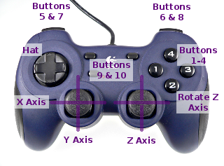

In the HAL configuration what is the difference in the abs-hat0x-is-pos and abs-rx-is-pos and just abs-x-is-pos?

Correct, I am working on a joystick. However the question relates to the difference in the 3 signals. "abs-x-is..," must be different than "abs-hat0x-is...." What does the hat designator represent. Same for "abs-rx-is..." what does the r represent?

28 Jul 2018 11:10 - 28 Jul 2018 11:23 #115006
by dm17ry
Replied by dm17ry on topic Difference in abs-hat0x-is-pos and abs-rx-is-pos and abs-x-is-pos
Last edit: 28 Jul 2018 11:23 by dm17ry.

I suspect that what matters is what the pins do.
So set up a halmeter for each one, and watch the behaviour.
This is likely to be, to some extent, hardware dependent.
Halmeter is in the "Machine" menu in the Axis interface. If you can't find it in your interface (It can not be loaded from Touchy) then "halcmd loadusr halmeter" at the command-line will open one.
