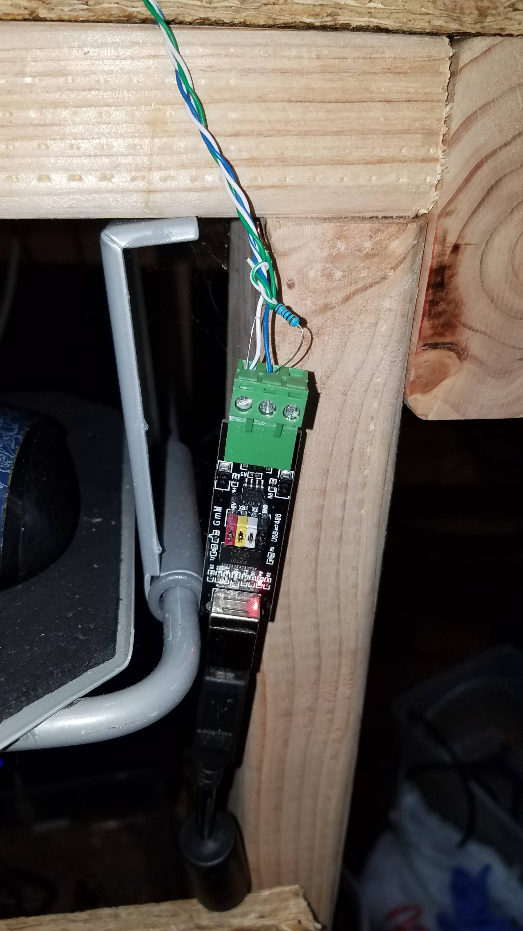

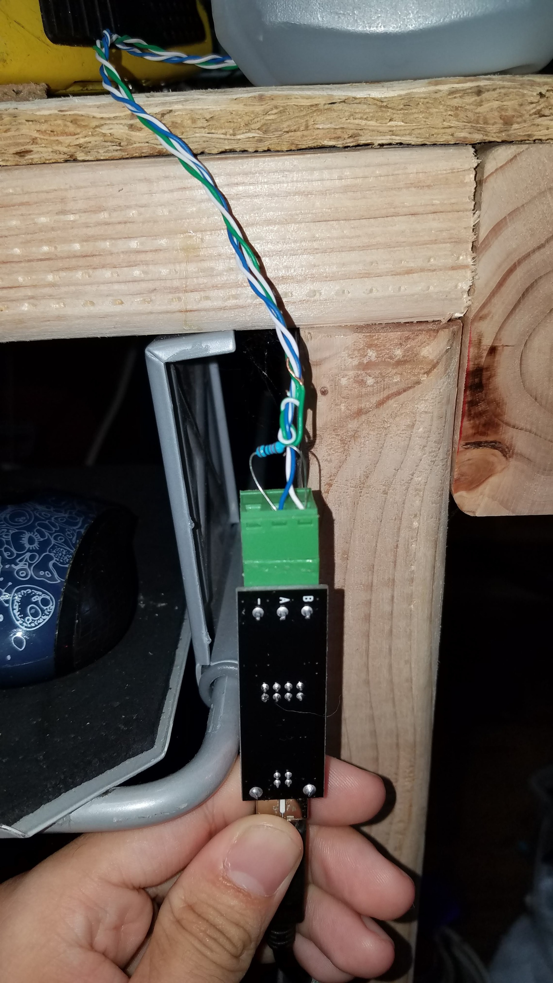

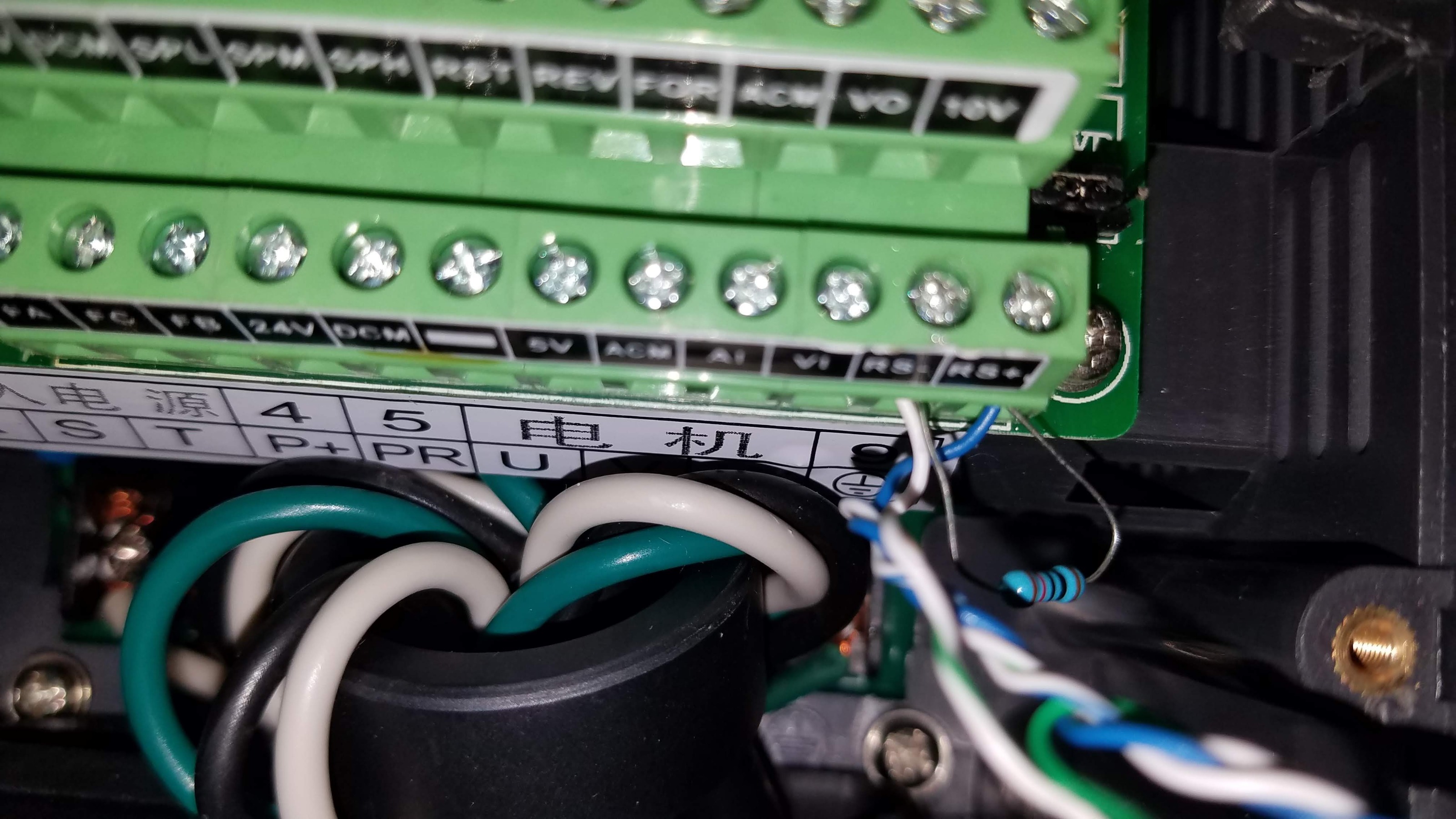

01 Aug 2018 15:46 #115317 by sir_wolf_art
Replied by sir_wolf_art on topic hy_VFD hy_VFD vfd.speed-command not setting RPM
So curtisa may have been right but not 100% sure on that because at that time I tried set the spindle to 24000 Which is the Max RPM of my spindle and that didn't work too. What I ended up doing was doing a factory reset on the VFD and reprogrammed it and it seems to work now but I'm now only getting one way communication now I can talk to the vfd but it's not sending any data back the “vfd.error-count” pin keeps counting up. The USB to rs485 has leds for both RX and TX and both are flashing.
I going to incould pics of the wiring as am also using 2 120ohm resistor on both ends of the twisted pair cable on I'm using.
I know i should Shielding on the twisted pair cable and vfd cable I haven't had the money to buy the VFD cable yet. I am using the wire that came with the machine originally.

02 Aug 2018 00:13 #115360 by curtisa
I am getting the following when in halcmd none stop after starting the spindle.
ERROR Communication time out (-12)
WAIT_DATA(): comms time out
What does work right now is commands going to the VFD. i can set RPM now YAY!
If you're getting 'Communication time out (-12)' errors but still able to control the VFD then the comms between the computer and VFD must be dropping in and out occasionally. Maybe there is a difference in communications parameters between the two (eg, stop bits). Can you confirm that the 'loadusr' command you are using is still:
loadusr -Wn vfd hy_vfd -n vfd -d /dev/ttyUSB0 -p none -r 9600 -s 1
And that the VFD is still set as:
PD001 = 2
PD002 = 2
PD163 = 1
PD164 = 1
PD165 = 3
Maybe the USB-to-RS485 converter is faulty? They are pretty cheap, so you could order a new one to try swapping out.
Shielded RS485 cable will help, particularly since you seem to have your RS485 data wires positioned quite close to the motor wires in that bottom photo.
Terminating 120ohm resistors may not be required. The assumption is neither your USB-to-RS485 converter or the VFD have them installed internally, which may or may not be the case. FWIW I have not installed terminating resistors on my HY setup and comms works fine with no errors.

03 Aug 2018 11:04 #115498 by andypugh
It might be worth using shielded cable and connecting the shield to the GND terminal. Possibly at both ends, possibly at only one end.
For Modbus I like to use DMX cable (as a handy 2-core+ screen)

03 Aug 2018 15:30 #115528 by sir_wolf_art
yea some thing was not right with it. Luckily I had a spare on hand that i was using for programming with an Arduino (try learn modbus). It is communicating properly now.
