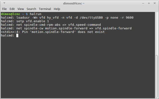

Hi guys,
I am trying to control the spindle with rs485 according to these instructions buildyourcnc.com/FAQ/13271.
However, as I run LinuxCNC I get the error "./custom.hal:10: Pin 'motion.spindle-forward' does not exist". Also, when I execute the halcmd in terminal I get the same error.
Why is this?
I am using 2.8.0 pre 1
The error log is attached.
Thanks!
Why is this?
Thanks!

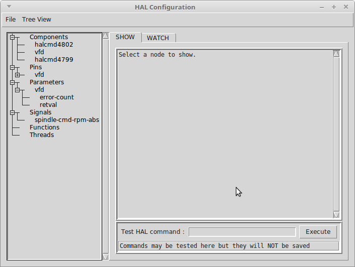

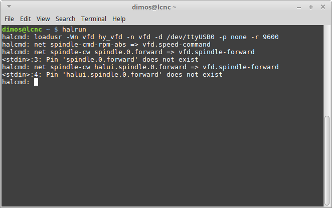

I tried the below with no luck. Also should't I see a "spindle" component in the halshow (see screenshot)?
net spindle-cw spindle.0.forward => vfd.spindle-forward
> Pin 'spindle.0.forward' does not exist
and
net spindle-cw halui.spindle.0.forward => vfd.spindle-forward
> Pin 'halui.spindle.0.forward' does not exist
Thanks!
and
Thanks!

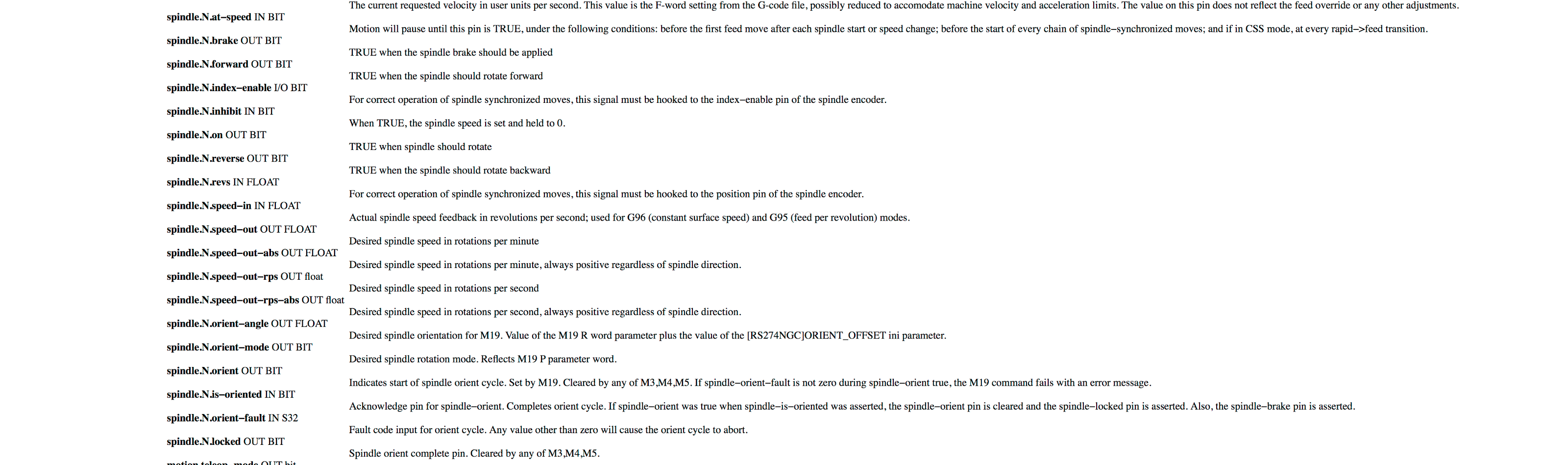

spindle is actually part of motion, take a look at motion in the 2.8 docs, thats how I found it.

10 Oct 2018 07:46 #118629
by racedirector
Replied by racedirector on topic v2.8.0 - Pin 'motion.spindle-forward' does not exist
