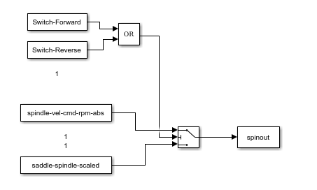

I also have a potentiometer on the saddle to be able to command spindle rpm when working manually without having to turn away to the pc. I am having some difficulty in HAL connecting the potentiometer.
In brief, I have the output of the pot connected to a scale component to scale output to a float value correctly for the maximum RPM of the spindle.
I’m having trouble connecting the output of that signal to the pin ultimately commanding spindle speed.
Basically for the pot and scale output I have:
net saddle-spindle-pot hm2_7i76e.0.7i76.0.0.analogin3
net saddle-spindle-pot scale.manual-spindle.in
net saddle-spindle-scaled scale.manual-spindle.out
setp scale.manual-spindle.gain 230
Where the issue lies is in tying the output signal (saddle-spindle-scaled) in to the spindle RPM command pin/signal as I keep getting debugs that the appropriate pins already have other pins connected. As such I’m unsure of what component (mux?) or HAL syntax to use to bring this in.
Currently, this controls the spindle:
net spindle-vel-cmd-rpm-abs <= motion.spindle-speed-out-abs
net spindle-vel-cmd-rpm-abs hm2_7i76e.0.7i76.0.0.spinout
But as I said earlier, every time I use a component (mux or otherwise) to connect signal “saddle-spindle-scaled” to signal “spindle-vel-cmd-rpm-abs” or to hm2_7i76e.0.7i76.0.0.spinout, I am met with a roadblock telling me it cannot be done.
If possible, could you please help with either the correct syntax or the correct component to join the scaled potentiometer output to the spindle rpm command pin (spinout).

Post your hal file and if possible the error it gives, I can try to help. Basically you can't have two signals going to the spinout pin. If you were trying to use a mux it should work, maybe it just needs some tweaking.

I ended up doing pretty much exactly as you've said, works correctly, and have all safety devices (foot brake, spindle cover) integrated to do their thing.
I did end up using an estop-latch component en-route so that whenever the foot-brake is pressed it commands off the spindle and latches it off until the M3/M4 switch on the saddle is moved back to the off position and thus resets.
