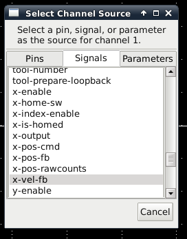

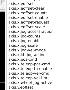

Now I open Linuxcnc and goto machine>halscope and start it. Accept Select Sample Rate by pressing OK and the Halscope opens. I pick Channel 1 and the list of channel selections opens. But here's the rub, the list I am seeing under pins, signals, and parameters doesn't seem to include any of the values shown in the tutorial.
I've been unable to find axis.1.joint-vel-cmd or any of the others? Is there some other list that i should be looking to?

20 Nov 2018 17:24 #121074 by Todd Zuercher
Replied by Todd Zuercher on topic Halscope tuning servos Question
Part of your problem is that the tutorial was written long before the joint/axis split in Master that you are using. So all of the pin names mentioned in the tutorial are using the old naming scheme. For example the pin you are looking for "axis.1.joint-vel-cmd" was renamed to "joint.1.joint−vel−cmd".
For the most part, I think most of the pin names you are looking for and can't find will have been renamed with the "axis" at the begining renamed to "joint".

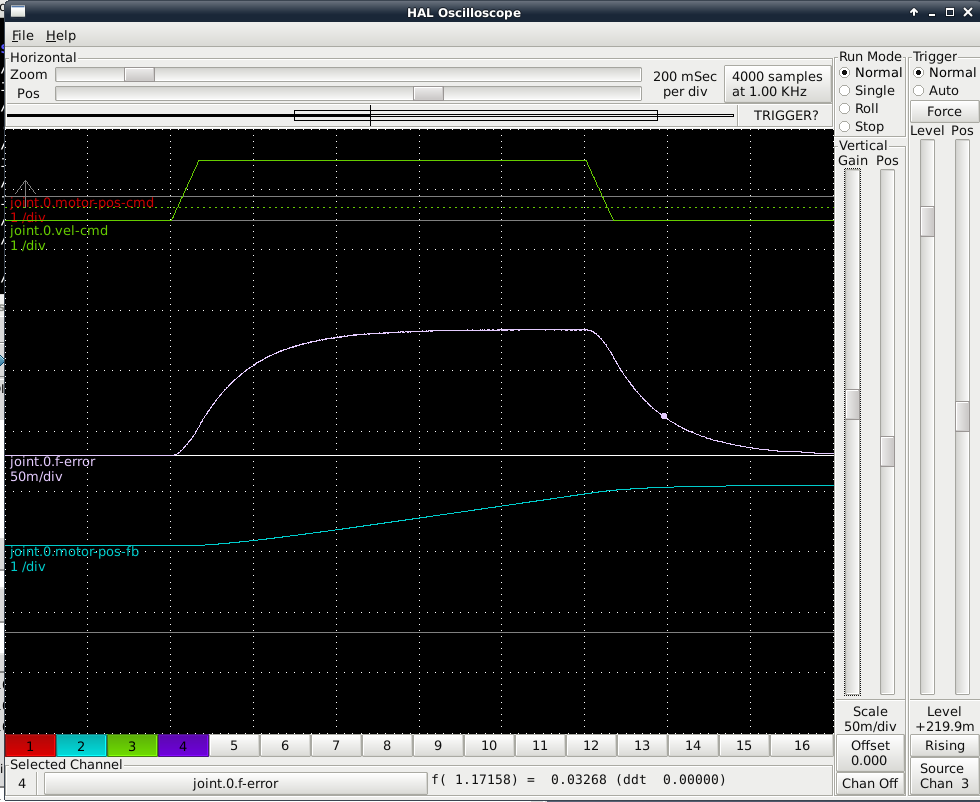

21 Nov 2018 19:23 - 21 Nov 2018 19:25 #121159 by jamby
Replied by jamby on topic Halscope tuning servos Question
Andy thanks
Okay I went out to the shop and played with the halscope and used these PINs
joint.0.motor-pos-cmd
joint.0.motor-fb
joint.0.vel-cmd
joint.0.f-error
these are for X axis on my machine and the readings below are with 1.0 inch at rapid / 60 ipm and 0.5 inch same fedrat.
Oddly the oscilloscope only responded to + movements.
It took me a while to learn which sliders to use to get the correct, well to match the example in "Servo Tuning Tutorial" but this is as close as I could get
I still can figure out what to do to get a channel back if I push the "Chan Off" button? yes I just had to push it.
I recovered by deleting the autosave file
1.0 inches in X axis at rapid/60 inch per minute. G0 G91 X1
0.5 inches in X axis at rapid/60 inch per minute. G0 G91 X0.5
They look good to me but what do I know?

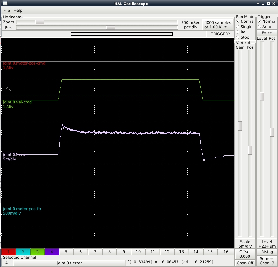

21 Nov 2018 20:50 #121176 by jamby
alan_3301
I reran the scope and paid attention to having the trigger set to channel 3 and then to select channel 4 joint.0.f-error so its the active one. Once I ran the machine again and a new plot returned I found I could move the gain slider up and down and see the curve generated from different angles.
Here's the better one.
I also learned to save a file for each axis so I didn't have to keep reloading the channels.
Thanks for the help
Jim

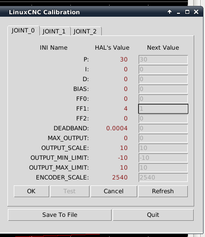

21 Nov 2018 21:26 - 21 Nov 2018 21:28 #121178 by PCW
Replied by PCW on topic Halscope tuning servos Question
Looks like you need (adjust in this order)
1. Higher FF1 ( adjust for 0 error during constant speed motion )
(if the following error is in the direction of velocity you need more FF1,
if the following error is in the opposite direction of velocity, you need less FF1 )
2. Higher P term ( adjust till its unstable then back off maybe 30% )
Easiest way to adjust things live is via the calibrate menu

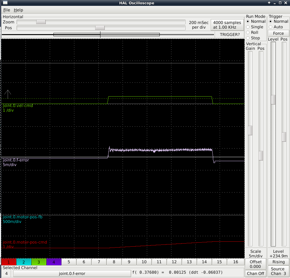

Here's some current scopes:
this is at 20 ipm (short jog)
this is at 7 ipm (short jog)
this is the calibration screen
