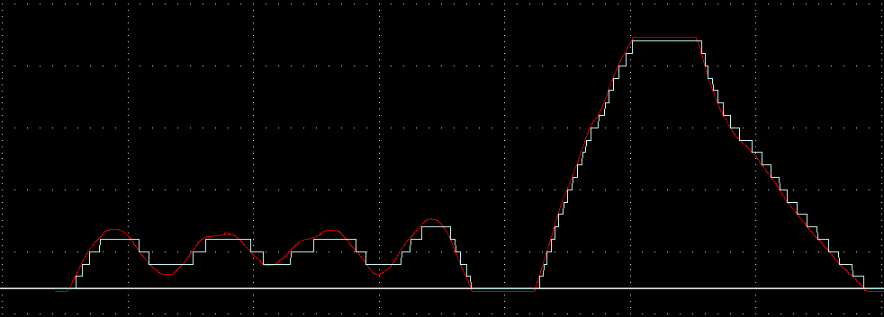

I finally got this to work as I like it.
Here's the the relevant part of my HAL file:
Along with that, here's a screen shot of the halscope output:
The smooth trace represents the scaled voltage input, and the quantized trace is the desired output. I created this by setting up the traces and manually turning the the potentiometer knob with the run mode set to Roll.
Note that there is a hysteresis; at any given point, on the slope, the required change in input to effect the output is 1. This means that so long as the analog noise is less than +- half of a "step," the output will be stable.
I would be interested in learning if there is an easier way of accomplishing this. After I was all done I saw the wcomp component, which seems to be at least slightly neater.

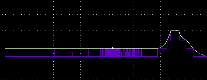

For comparison, here's the an illustration of the original problem. When the input sits at the threshold, a small amount of noise or even adjusting one of the nearby potentiometers causes a jump in the output.

net feedoverridequant => halui.feed-override.countsAlong with that, here's a screen shot of the halscope output:
