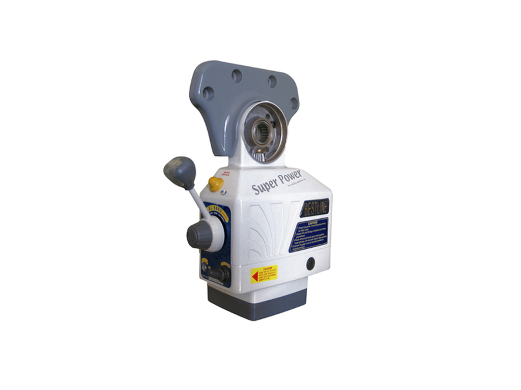

06 Feb 2022 07:42 #234084 by Nigel Pearson
Replied by Nigel Pearson on topic How to use AC motor with axis?
Sorry to revive an old thread, but it seemed the most appropriate.
I'm trying to do a hack. Brutal inaccurate axis control on a mill.
Like many mills, it has DRO scales, and bolt-on "power feed" units on the X and Y. The ones with a lever for direction, speed control, and an AC motor in there which is geared down by a bevel gear that bolts on near the mill axes handles:
1) Have people tried closed loop feedback seperate from the axis motor shaft?
i.e. measuring the table position, which is 2 or 3 mechanical moving parts away from the motor pulses
(reduction gear, axis screw float/backlash, table gib slop+rotation)
2) How hard is it for LinuxCNC to keep up with TTL scale (quadrature) signals?
3) If that is possible, any suggestions for interface boards to do it?
This mill has ball screws on X+Y, so if my hack really isn't workable, the owner can pay for proper stepper/servo motors, but I'm trying to save some money and keep all the manual stuff still working
06 Feb 2022 12:27 #234097 by andypugh
Replied by andypugh on topic How to use AC motor with axis?
Yes, but usually with tighter coupling than you are suggesting, and generally with velocity-control servos.
But, depending on what you want, it might work. How close do you want to get to the commanded position?
Does the motor move at constant speed, or is it software-variable?
That all depends on the sample rate of the interface, the resolution of the scales and the speed of motion.
With the parallel port you are likely to hit the limit if you have fine scales and/or try to move fast. With the Mesa / Pico / General Mechatronics interfaces the sample rate is several Mhz so you are pretty unlikely to hit the limits.
What do you have now? I would be tempted to experiment with the parport if that is what you have.
08 Feb 2022 08:30 #234332 by Nigel Pearson
Thanks for your reply, Andy.
I only have slight experience with parallel port setup.
These motors could have variable speed if I work out how to drive them that way. Of course, like most non-steppers, they are low torque at low speed, so there is some tuning issues there.
