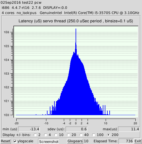

In my experience, Latency doesn't directly depend on CPU horsepower, especially with RTAI (which has quite decent latency on Atom D525s which are about 1/5 the speed of your I3) , Preempt-RT seems more influenced by raw CPU speed, but you have a CPU with decent performance. Also in my experience restricting LinuxCNC to a single CPU may worsen Preempt-RT performance.
Have you gone through the usual suspects in BIOS setup options (disabling all power saving modes, fan speed control, Cstates >1 etc etc?)
Will RTAI (32 bit Wheezy) run on your PC? it will likely have lower latency than Preempt-RT, though Preempt-RT can have quite decent latency on the right hardware:
(servo thread only because its running hardware stepgens)

32 bit is not much of a disadvantage unless you have more the 4G of RAM
I think the main reason that there is not a standard 64 bit LinuxCNC dist is that
there has not been a stable 64 bit kernel RTAI created.
I would definitely disable all power saving options in the BIOS and re-test
perhaps trying with just 1 RT CPU and both cores RT, really long latencys are _very_ often power management related
