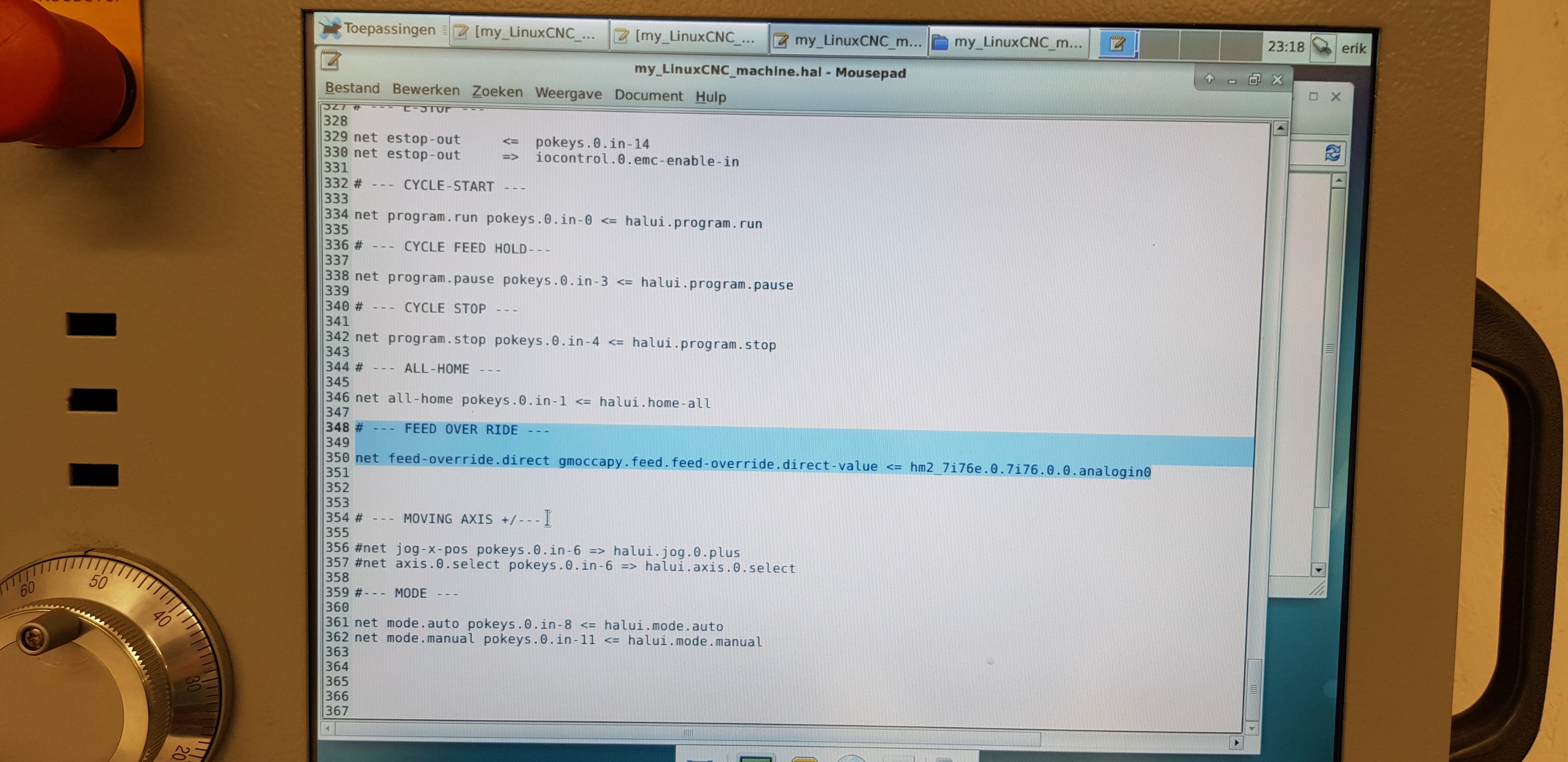

So I did. Changed it in the machine hal file. Got a debug file information that pin 'gmoccapy.feed.feed-override.direct-value' does not exist.
Replied by Erikcnc on topic Physical Feed override knob
Ah! That creates a new "signal" called "gmoccapy.feed.feed-override.direct-value".
The format of a "net" statement isnet signal-name pin2 (pin2....)
trynet feed-override-direct gmoccapy.feed.feed-override.direct-value <= hm2_7i76e.0.7i76.0.0.analogin0

05 Apr 2019 21:18 #130368
Replied by andypugh on topic Physical Feed override knob
It seems likely that a gmoccapy pin won't exist until gmoccapy has loaded. So the line needs to go in the Posgtui Halfile. (look in your INI to see what that file is called in your config)

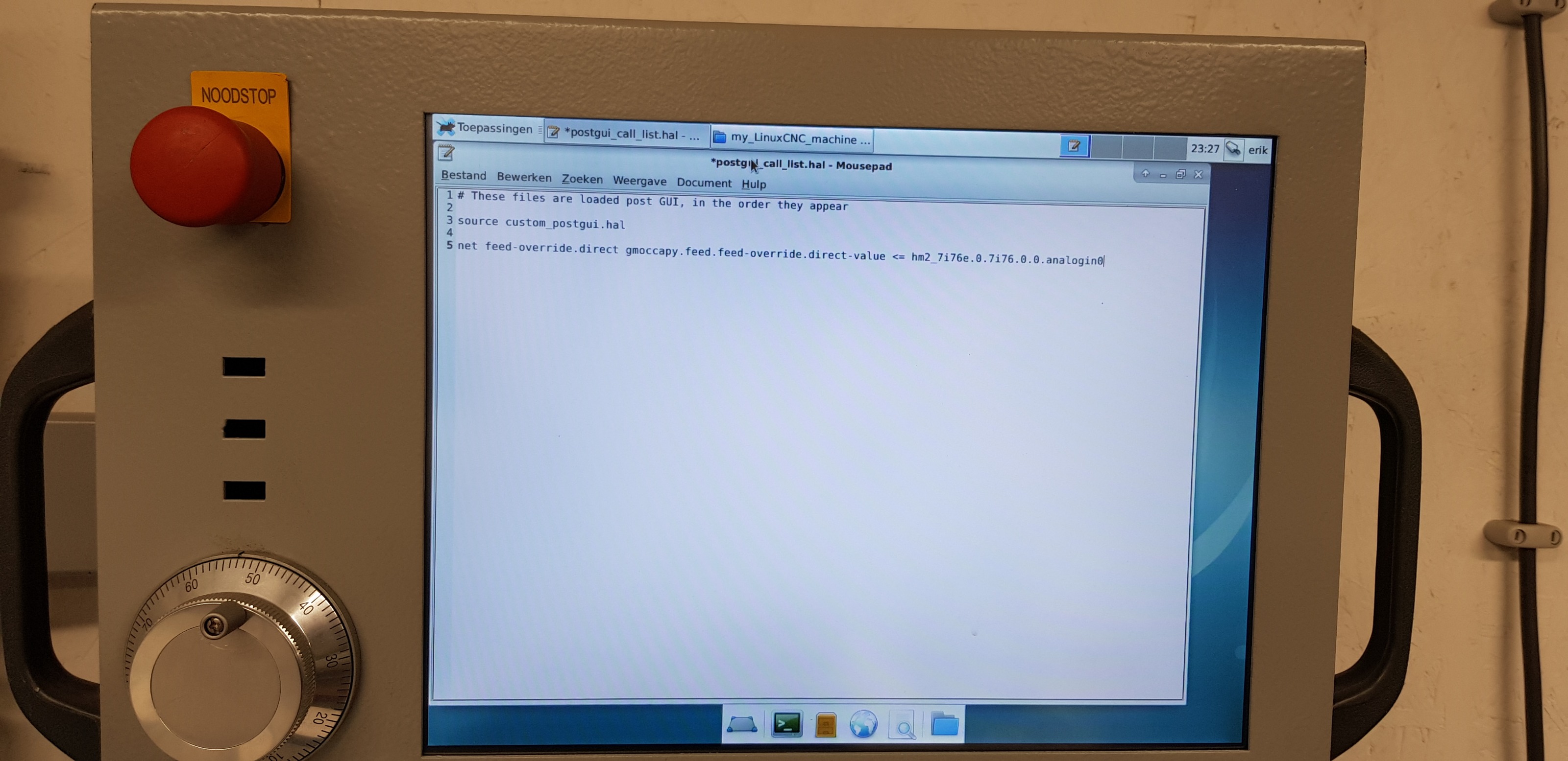

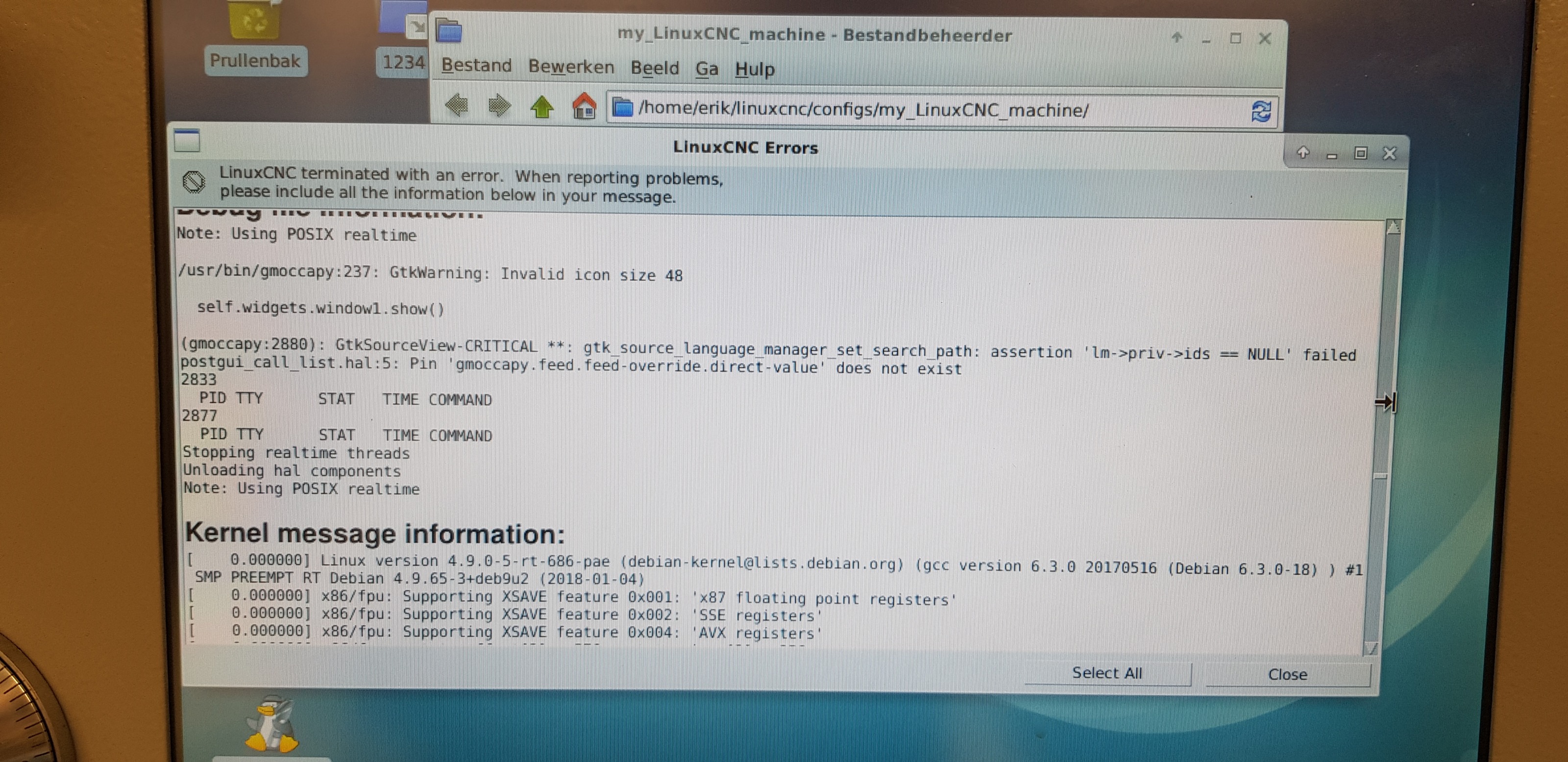

05 Apr 2019 21:28 #130370
by Erikcnc
That would be the postgui_call_list.hal if I'm right.
Following error appears. Another error. See attachment.

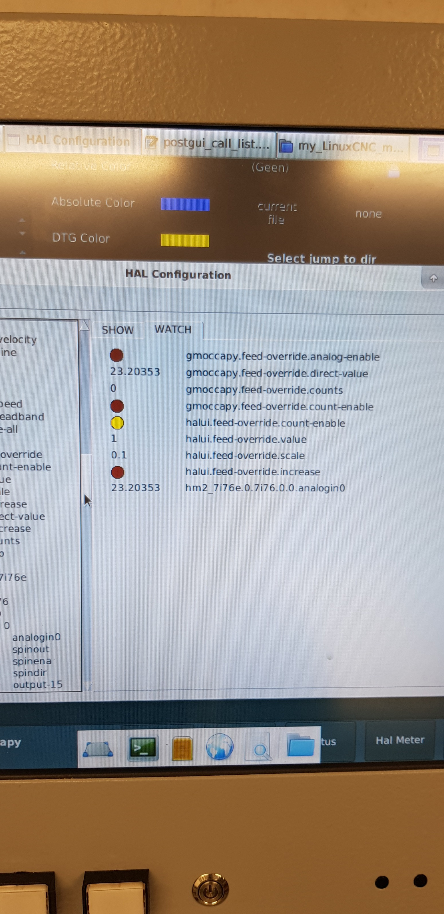

05 Apr 2019 23:23 #130375
Comment-out the line, boot LinuxCNC, find out what that pin is really called using halshow.
(I think that is in the settings menu with GMoccaPy)

06 Apr 2019 08:06 #130387
by Erikcnc
Oke, getting there. that changed some thing. In halshow its shows:
Gmoccapy. feed-override.direct-value
Both responding to the potentiometer. But not the slider in gmoccapy Gui.

06 Apr 2019 13:09 - 06 Apr 2019 13:10 #130393
Replied by Todd Zuercher on topic Physical Feed override knob
A potentiometer is an absolute device, You can not use inputs from both the potentiometer and the slider. You may be able to use the value input from the potentiometer to move and control the slider in Gmocappy. (Is this what your current problem is?) But you won't be able to use the slider to change the value of the potentiometer.
