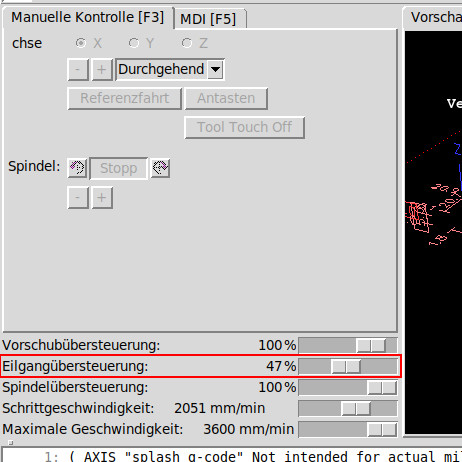

hi
the slider from AXIS
can this be set in the HAL from Startup to 50%
HOW doi i do this

not that elegant but it workes
2.8.pre
into a postgui HAL file
# rapid feedoverride at startup
# first enable the inputs
setp halui.rapid-override.count-enable 1
setp halui.rapid-override.direct-value 1
# set 2 values to trigger by mashine on
loadrt mux2 count=1
addf mux2.0 servo-thread
setp mux2.0.in1 5.0
setp mux2.0.in0 1.0
net trigger_rapid_override mux2.0.sel <= motion.motion-enabled
#convert the values to the needed float to s32
loadrt conv_float_s32 count=1
addf conv-float-s32.0 servo-thread
net conv_tofloat mux2.0.out => conv-float-s32.0.in
#set the value to the override from halui
net rapid_count conv-float-s32.0.out halui.rapid-override.counts Attachments:

11 Apr 2019 15:11 #130670
by pl7i92
Replied by pl7i92 on topic SOLVED G0 max feed override Axis at Startup
2.8.pre
loadrt mux2 count=1
setp mux2.0.in1 5.0
setp mux2.0.in0 1.0
