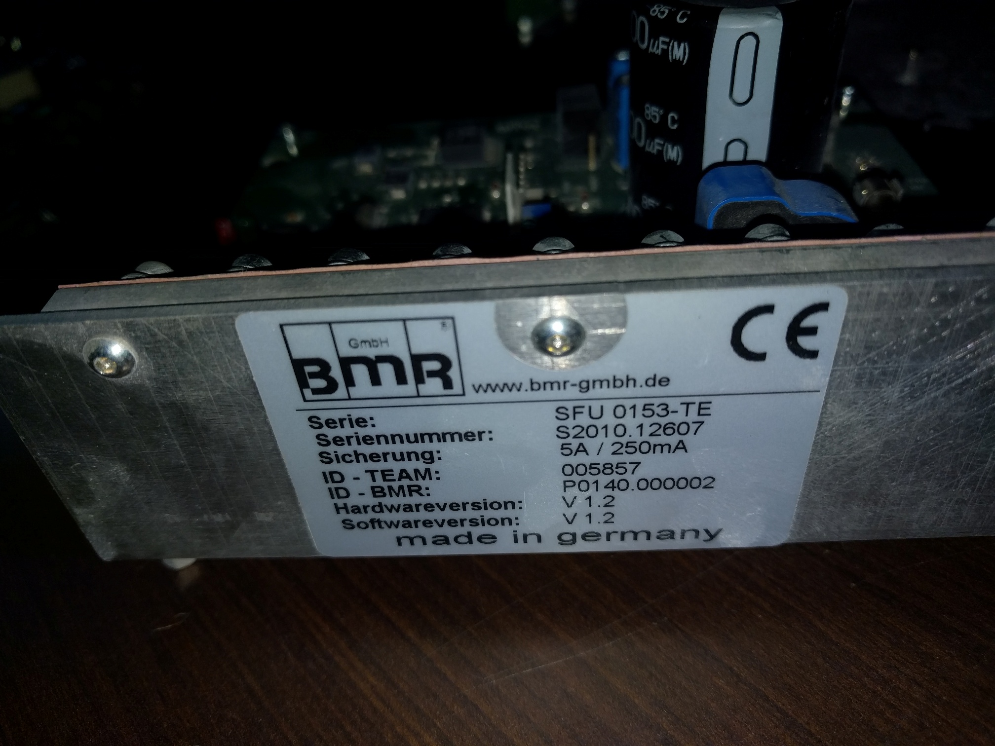

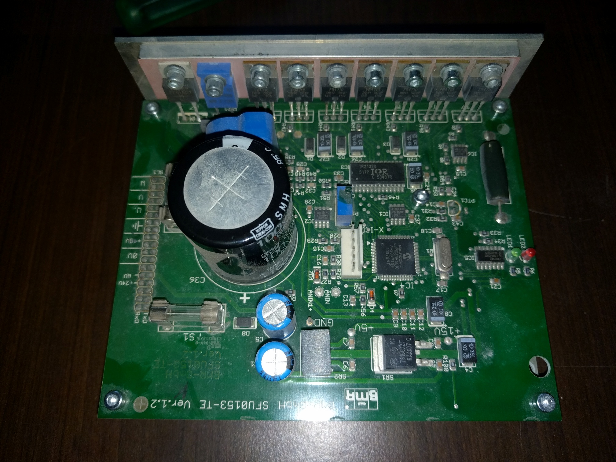

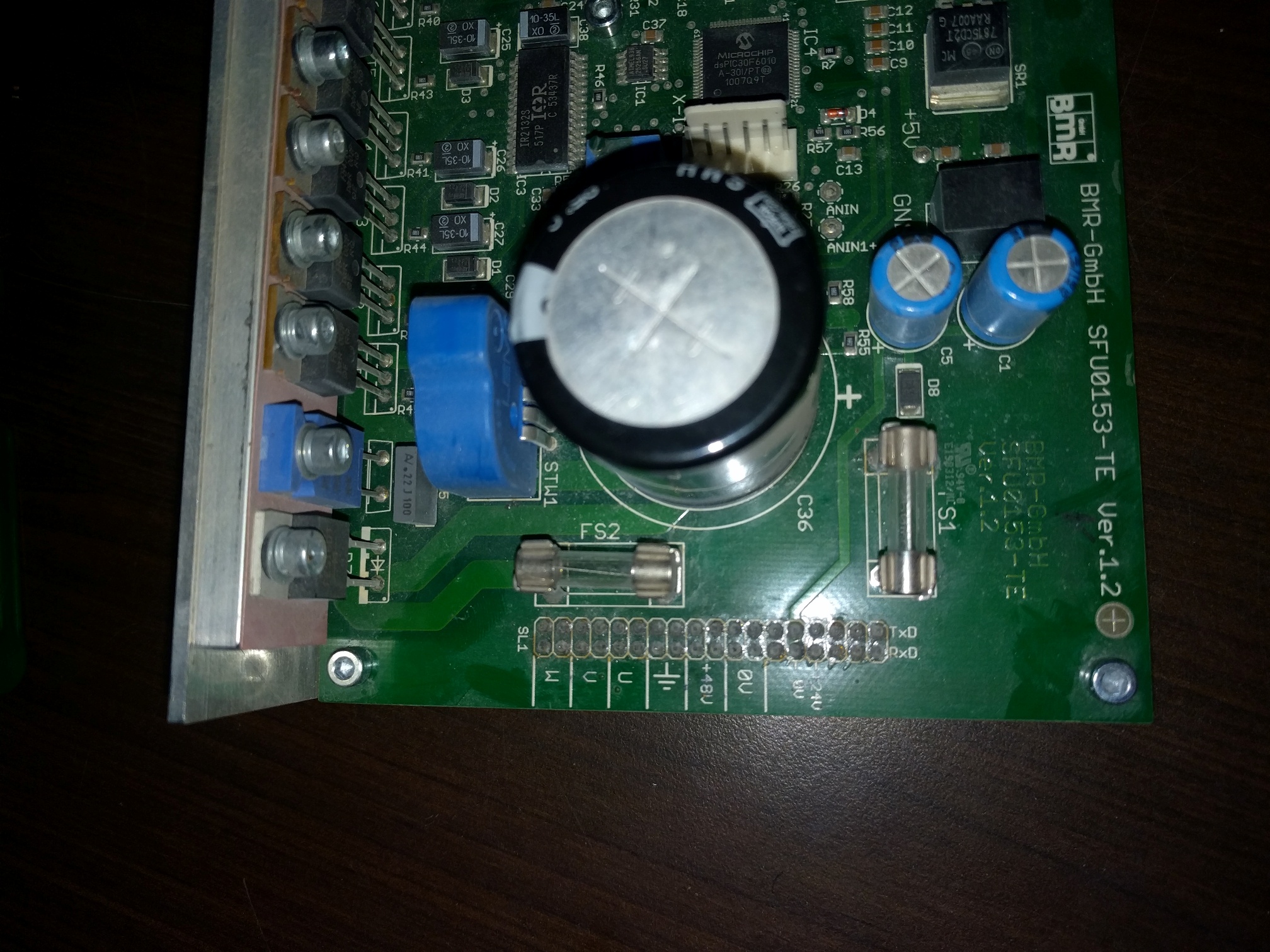

I have recently came to one spindle and driver set for one retrofitting, its designed to work togather, already tried to configure spindle with different Delta VFD but no luck, spindle is not powering up, its Alfred Jaeger 44V 1000HZ 0.18KW 60000RPM Auto tool clamping spindle.
Basically i am making this setup for PCB drilling machine, so need to use this set as it is.
after hair pulling with different VFDs i decided to check its OEM Supplied drive which is BMR make SFU0153 as per attached photos and datasheet and 232 commands,
My query is, can i use this SFU0153 driver with linuxcnc to control Spindle? it has no Analog input for spindle speed or any Digital input for Start Stop ! (If it was existing i would hae loved to configure with parallel port BB so i bought other VFD to drive this spindle but my bad luck)
Any chances with this Rs232 drive ? or can i use 485 > RS232 Converter for this ? i have doubt since this driver is not accepting commands directly from RS232 its using safety TTL IC Max232 i have wired RS232 with this Max 232 converter and tested with its OEM BMR programming . software and its working fine.

A quick look in the attached doc expresses clearly:
This is a only via rs232 controlled device. The protocol is simple and has nothing to do with modbus or other industrial protocols. (that I know)
U need a pc with rs232 which is the normal serial interface. And 115k Baud is quite high, so you should not have to long cable. Double conversion to Rs485 makes it only complicated and the VFD has no pin to switch direction. If you really need longer distance you have to makes something special with 2x rs485 or 2x rs422.
For the soft I think best is to write a python based program that communicates via hal pins. It is beyond my momentary skills, but I think here on the list there are a few who can help you with a "base" rump. That example should contain the way to define digital and analog hal pins. What i'm not sure is if you can adress the serial from a program that communicates via hal-pins.

Yes Mike, i tried with Max232 serial chip with on board serial port and driver is working fine with its software and listed commands in manual. my hurdle is to talk with this Driver with EMC.
I understood your method, i m newbie in Linux and python.... any help would be much appreciated,

A workaround could be an intermediate Arduino.
Are you on an LPT solution?
Do you need to set different speed?

Yes i need to set different speeds, I am new to Arduino will be no issue i can play with... I am with PCI LPT setup.
