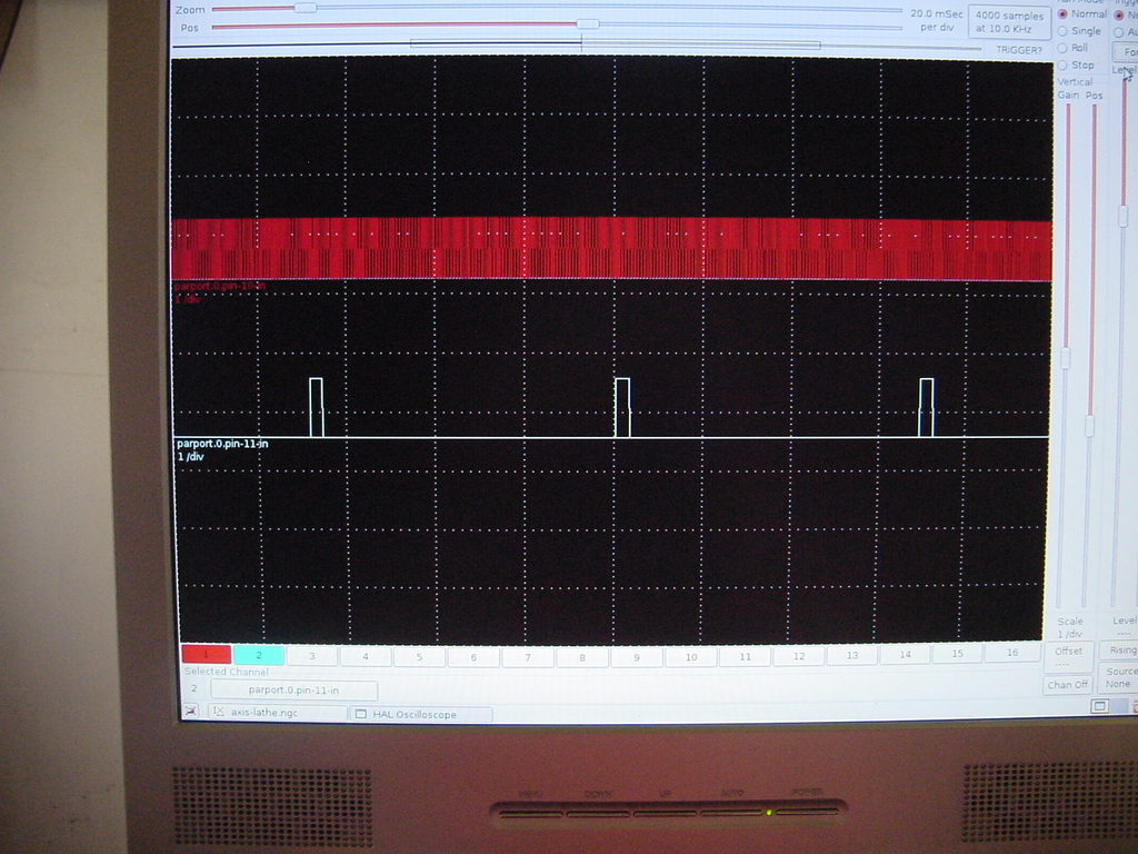

30 Jul 2009 10:08 #653 by welderfabrod
Replied by welderfabrod on topic Re:Screwcutting
Hi Alan and John I,m back again. Sorry its been a while but sad family business has occupied me for a while.
Back to the matter in hand i.e. scewcutting. The other reason I,ve not been online is I decided to build a new power supply for the lathe as the Emco one only delivered 16v to the steppers which limited my Max Velocity to 360mm per min. I now have 31v to the steppers giving 780mm per min which should be ample for threads up to about 1.25 pitch. Plenty for what I intend to do.
I have also installed a seperate 5v regulated supply for the spindle encoders and now have really strong pulses when veiwed on the HalScope. However I still have the problem i.e. the Z axis appears to stop start along the length of the thread. When watching the velocity on the Axis screen what appears to be happening is that when the index pulse is seen the Z axis will ramp up to max velocity (780mm p.m.) then drop back again, it will do this a few times along the length of the thread. If I reduce the spindle speed it will do this more often along the thread, if I increase the spindle speed it does it fewer times along the length of the thread. Its like its not seeing the spindle speed pulse and does'nt syncronize. All this is done with a 1mm pitch thread in the G76.
I also now have the rev. counter on Axis and this is working fine.
Here is my Mechanical info:
Screw pitch = 2.5mm
Motor pulley 16T Screw pulley 40T (2.5:1)
Motors 200 step HalfStepping i.e. scale 400
Max Vel. 780mm per. min.
My spindle speed is set manually and not controlled by software.
I also now have two set ups one with the spindle speed halfile that you kindly gave and another done with the stepconf. wizard and both give the same result.
Today I,m going to change the pins on the port just to see if anything changes. Desperation really.
Rod.
30 Jul 2009 12:04 #654 by BigJohnT
Replied by BigJohnT on topic Re:Screwcutting
I did complete my spindle with encoder feedback for testing here. Just to be sure you have the right HAL connections compare it to the manual which now has the connections needed for spindle feedback.
www.linuxcnc.org/docview/html//examples_spindle.html#r2
When running my spindle at 50 RPM using the g76 line from the sample program g76.ngc and increasing the length of the thread to 1.5" I notice the velocity readout from Axis kinda bounces around. I'm using a Mesa 5i20 card with a 2500 line encoder. The motion seems smooth to the eye and it does wait at the begining of each pass for the index pulse. Running at 300 RPM the velocity is much smoother.
Run your spindle and take a look at the encoder velocity with halscope at different RPM's. Just looking at my encoder velocity at 300 RPM it is a slightly lumpy but regular spaced pattern and at 1000 RPM it is smooth.
John
30 Jul 2009 18:20 - 30 Jul 2009 18:23 #658 by welderfabrod
John thanks for coming back. Just a bit more info, as the apparent stop start motion tended to reduce with increased spindle revs I wondered if it would get to a point where it would disappear altogether so I did a pulley change to get more revs and sure enough it did eventually disappear. this seemed to be at about 700 revs. in this case.
The Spindle Feedback as shown in the manual is basicaly what you get if you use the Stepconf Wizard to set it up.
I did as you suggested and watched the encoder velocity at different revs. The results are below. I,m not sure what the info HalScope is giving means so does it look like yours at all.
Encoder velocity at 8000 samples.
1) At 900revs
2) At 600revs
3) At 300revs
Pulses on Pins 10 and 11 at 900revs
Hope this works have,nt done this before.
Rod
Nope did,nt work got the same on them all not sure why ?????
