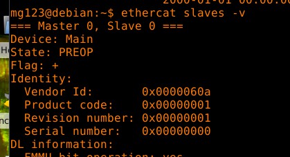

excuse me.I'm having a problem. I'd like some help.
The hardware configuration :
1 slave is estun company ,it type is PRONET-04AEG-EC
2 lenovo E40 conputer
The software configuration
1 debian7
2 etherlab1.5.2
3 linux-headers-3.4-9-rtai-686-pae
Error description
I use the PDO command line to control the speed change of the motor. For example, the "ethercat download" command. But this is driven not by Linuxcnc, but by the command line. So I started trying to open the "***ini" file using the "Linuxcnc" command, but the following error occurred
Specific information on slave

Error description
mg123@debian:/mnt/hgfs/LinuxCNC/linuxcnc-master/configs/ethercat_3axis_CIA402$ linuxcnc /mnt/hgfs/LinuxCNC/linuxcnc-master/configs/ethercat_3axis_CIA402/basic_3_CIA402.ini
LINUXCNC - 2.7.14
Machine configuration directory is '/mnt/hgfs/LinuxCNC/linuxcnc-master/configs/ethercat_3axis_CIA402'
Machine configuration file is 'basic_3_CIA402.ini'
Starting LinuxCNC...
Found file(REL): ./basic_3_CIA402.hal
lcec_conf: ERROR: unexpected node master found
lcec_conf: ERROR: Parse error at line 1: parsing aborted
./basic_3_CIA402.hal:1: waitpid failed lcec_conf lcec_conf
./basic_3_CIA402.hal:1: lcec_conf exited without becoming ready
/home/mg123/linuxcnc_debug.txt
and
/home/mg123/linuxcnc_print.txt
as well as in the output of the shell command 'dmesg' and in the terminalSpecific information on slave
Here is the ini file
Here is the hal file
Here is the xml file

this same error : lcec_conf: ERROR: unexpected node master found .
in the conf.xml posted above the "masters" statement is missing, so the format is wrong.
You need an <masters> on top of the file, and an </masters> at file end. This is because you can have more then one master in an setup.
And there exists no hal_type "special32", use "S32" or "U32" .
