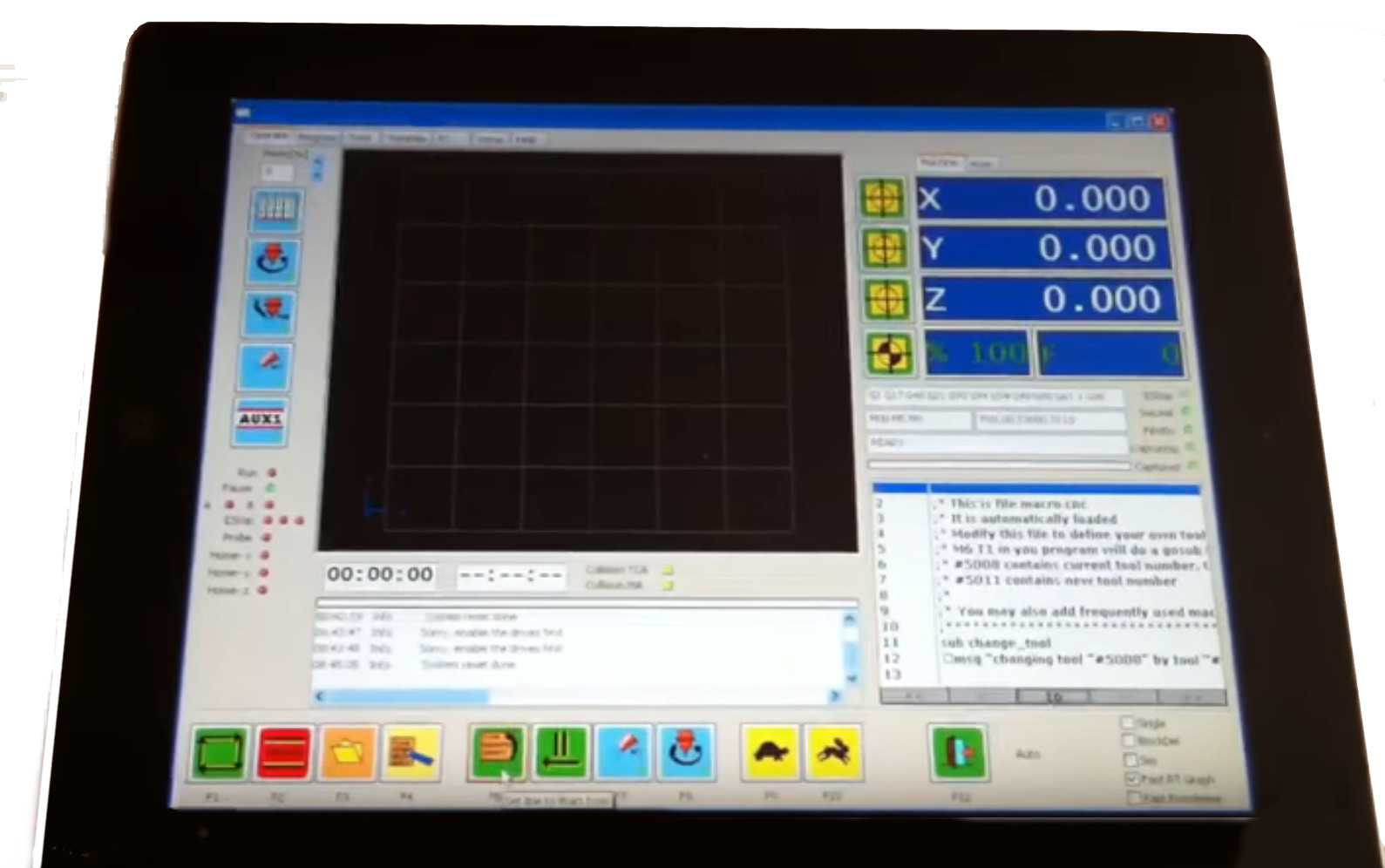

05 Sep 2019 06:38 #144215 by pl7i92
Replied by pl7i92 on topic Hal Standalone and a Java gui
this is a nice project lots of people will love a boost to edingCNC users that are android Java CNC aplicants
any Images so far
