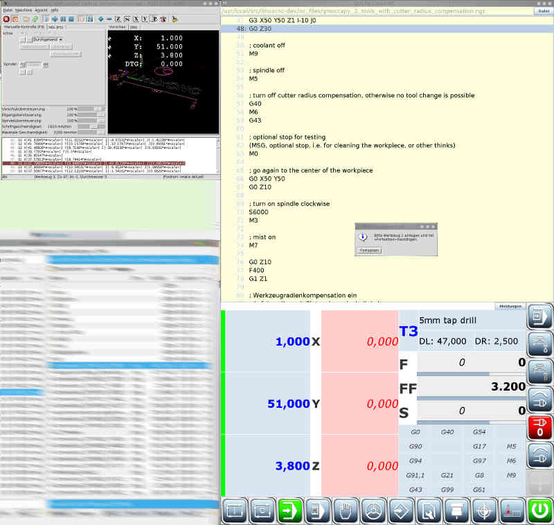

26 Oct 2019 06:04 #148814
by Reinhard
Replied by Reinhard on topic out of sync gcode lister / missing status update?
to show the discrepancy ...
The last movement executed is the "G0 Z30", but DRO does not reflect the position (neither axis, nor my app. Axis runs as check only - linuxcnc is controlled by my app, but toolchange popup is from axis manualtoolchange).
Tool change happens at line 54, but gcode-lister stays at 48 ...
... not obvious for a beginner
