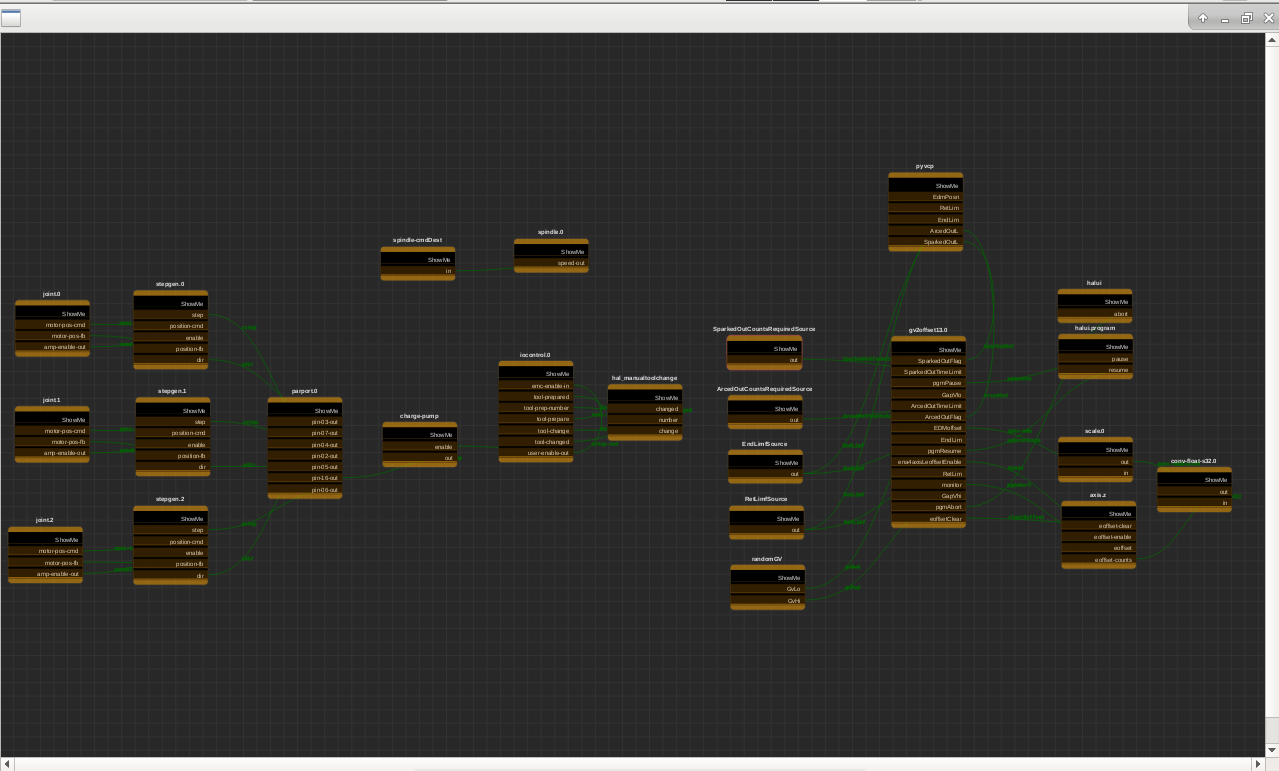

03 Jan 2022 16:22 #230663
by tjtr33
Replied by tjtr33 on topic Graphing a HAL configuration
I got parsing output ofto create new graph automatically.
TODO allow multiple hal, bash. python, M1xx files to be aded to project dictionary.
Those can be data sources or sinks and normall y Hal doesnt know about them.
( Like a bash scripot that sets a signal or pin )
TODO: Spread out initial placement to make rats nest easier to work with.
(usinga grid suited to number of nodes ( ie: 3x3 or 5x5 etc)
TODO FilePickers
TODO a node editor to change the side where net enters
and allow changes to pin order in node (helps untangle)
TODO write to hal
Happy New Yeay
Chok Di Pi Mai!
'halcmd show sig'TODO allow multiple hal, bash. python, M1xx files to be aded to project dictionary.
TODO FilePickers
TODO write to hal
Happy New Yeay
Chok Di Pi Mai!
- tjtr33
- Posts: 170
- Thank you received: 54
10 Jan 2022 14:24 - 28 Jan 2022 16:37 #231307
by tjtr33
now on github
github.com/tjtr33/Nodz
news: 22jan2022 23:00 now has automatic converter
if you capture the output of 'halcmd show sig > yourfname.signals'
then you can choose that file
and save the converted output ( yourfname.json)
You can then load yourfname.json and see it as an editable moveable zoomable graph
Please upload example showsig files so I can test ( i dont have your hardware, so cannot create )
Now runs with python3 ( 3.7) 29jan2022
Try with the 3 supplied files SaveMe01... SaveMe02... Save<e03...
use to see the progression from[/code]
use
python3 nodz_demo.pyhalcmd show sig > mysystem.signals[code]to the json file for Nodz
to a ratsnest
to a logical grouping
to an untangled , clean digraph
TomP
