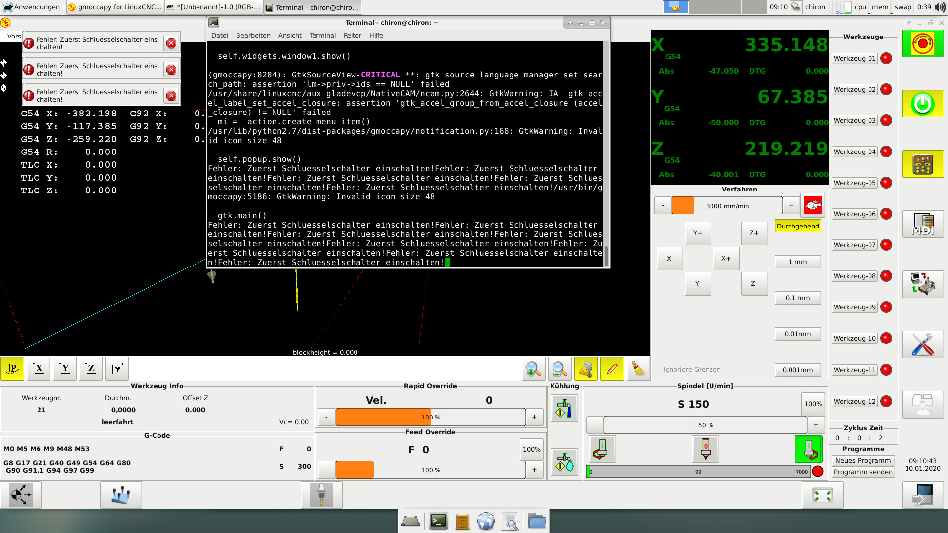

06 Jan 2020 10:56 #154139 by ChironFZ16
I need help for Comp File programming was created by ChironFZ16
Hallo
I have old Comp file for Programming Linuxcnc 2.5.x , they worked until linuxcnc 2.8, but with the newer 2.9 masters I always get error messages and some functions when changing tools do not work anymore.
I would be very grateful if someone could help me.
I have tried a little bit, but I can't see the forest for the trees. ;)
Especially syntax and variables, whether they are correct.
Wekzeugwechsler.comp

pin in bit   X-Endsch-Rechts          = false   " ( Pin: halui.joint_0.on-soft-max-limit )     X-Achse Endschalter Rechts ";
pin in bit   Y-Endsch-Vorne           = false   " ( Pin: halui.joint_1.on-soft-max-limit )     Y-Achse Endschalter Vorne ";
pin in bit   Z-Endsch-Oben            = false   " ( Pin: halui.joint_2.on-soft-max-limit )     Z-Achse Endschalter Oben ";
pin in bit   X-Endsch-Links           = false   " ( Pin: halui.joint_0.on-soft-min-limit )     X-Achse Endschalter Links ";
pin in bit   Y-Endsch-Hinten          = false   " ( Pin: halui.joint_1.on-soft-min-limit )     Y-Achse Endschalter Hinten ";
pin in bit   Z-Endsch-Unten           = false   " ( Pin: halui.joint_2.on-soft-min-limit )     Z-Achse Endschalter Unten ";
pin in float Spindel-Fehler           = 0       " ( Pin: Spindel.Meldung )                     Rückmeldepin für den Spindel Fehlercode ";
pin in float WZW-Fehler               = 0       " ( Pin: WZW.Meldung )                         Rückmeldepin für den WZW Fehlercode ";
pin in float WSW-Fehler               = 0       " ( Pin: WSW.Meldung )                         Rückmeldepin für den WSW Fehlercode ";
pin in float SF-Fehler                = 0       " ( Pin: SF.Meldung )                          Rückmeldepin für den SF Fehlercode ";
// Ausgaenge
pin out bit   Taster-Fehler-Reset     = false   " ( Pin: halui.abort )                         Taster für Fehler Reset ";
pin out bit   Programm-Pause          = false   " ( Pin: halui.program.pause )                 Programm wird pausiert ";
pin out bit   Programm-weiter         = false   " ( Pin: halui.program.resume )                Programm wird fortgesetzt ";
// Interne Variablen
variable int Axis_warten1              = true;      // Verriegelvariable 1
variable int Axis_warten2              = true;      // Verriegelvariable 2
variable int Axis_warten3              = true;      // Verriegelvariable 3
variable int Axis_warten4              = true;      // Verriegelvariable 4
variable int Axis_warten5              = true;      // Verriegelvariable 5
variable int Axis_warten6              = true;      // Verriegelvariable 6
variable int Axis_warten7              = true;      // Verriegelvariable 7
variable int Axis_warten8              = true;      // Verriegelvariable 8
variable int Axis_warten9              = true;      // Verriegelvariable 9
variable int Axis_warten10             = true;      // Verriegelvariable 10
variable int Axis_warten11             = true;      // Verriegelvariable 11
variable int Axis_warten12             = true;      // Verriegelvariable 12
variable int Axis_warten13             = true;      // Verriegelvariable 13
variable int Axis_warten14             = true;      // Verriegelvariable 14
variable int Spindel_warten            = true;      // Verriegelvariable Spindel
variable int WZW_warten                = true;      // Verriegelvariable WZW
variable int WZW_warten1               = true;      // Verriegelvariable WZW Spezialwechsel
variable int WZW_warten2               = true;      // Verriegelvariable WZW Spezialwerkzeug
variable int WSW_warten                = true;      // Verriegelvariable WSW
variable int SF_warten                 = true;      // Verriegelvariable SF

Ich bekomme immer diese Fehlermeldungen und weiß nicht mehr weiter, irgendwo ist der Wurm drinnen.
Gibt es Tools/logging für API-Calls aufrufe?
I always get these error messages and don't know what to do, the worm is in there somewhere.
Are there tools/logging calls for API calls?
Any idea ?
Linuxcnc
LINUXCNC - 2.9.0-pre0-939-gadb5ab425
Turn it on from Konsole
linuxcnc -d -k -v linuxcnc/configs/chironFZ16/chiron.ini >error21.txt

10 Jan 2020 20:53 #154578 by andypugh
Replied by andypugh on topic I need help for Comp File programming
Do you know _which_ .comp file is causing the problem?

11 Jan 2020 08:06 - 11 Jan 2020 09:58 #154600 by ChironFZ16
Replied by ChironFZ16 on topic I need help for Comp File programming
Ja, hängt irdendwie mit den manuellen Werkzeugwechsel zusammen, der Schluesselschalter dient als Sicherungsfunktion.Ich habe einen 12Korbwechsler und kann damit jedes Werkzeug per Hand in MAN-Mode einwechslen, indem ich auf Werkzeug 1 oder Werkzeug 2 klicke.
Irgendwo in der WZW.comp ist ein Fehler drinnen der von der Linuxcnc 2.9 master nicht mehr unterstützt wird.
Oder es kann auch ein Fehler sein von Linuxcnc 2.9 master
Yes, it is somehow related to the manual tool change, the key switch serves as a safety function, I have a 12 basket changer and can change any tool manually in MAN mode by clicking on tool 1 or tool 2.
Somewhere in the WZW.comp there is a bug in there that is no longer supported by the Linuxcnc 2.9 master.
Or it could be a bug of Linuxcnc 2.9 master.

11 Jan 2020 14:03 #154607 by andypugh
Which user interface are you using?
It seems unlikely that the C-code is behaving any differently.

11 Jan 2020 15:48 #154622 by ChironFZ16
Hallo
LINUXCNC - 2.9.0-pre0-939-gadb5ab425 + Gmoccapy ;)
11 Jan 2020 15:59 #154623 by andypugh
The error output looks to be more Python-like than C-like, so I would suspect that there is a problem with interaction with Gmoccapy.
What happens if you switch [DISPLAY] to the Axis GUI?
(I suspect that a lot of HAL connections will break, in practice, and it won't be a simple test)
I don't think that the Gmoccapy author reads this section of the forum, it might be worth asking the same question in the Gmoccapy section (or linking to here)
Also, as an advantage, Norbert speaks better German than me.
