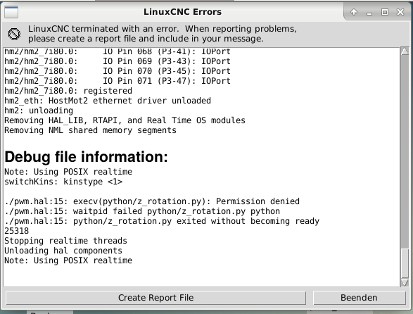

the component i load with "loadusr python python/z_rotation.py" because i have a seperate python folder in my config to make it a little more clean. Also the loading is right on the top of the hal file where the other "loadrt" are.
the pin connection is in my main hal file:
net classicladder_rotation_z_float classicladder.0.floatin-01 <= z_rotation.z-rotated-angle
when i add -Wn i get an error (uploaded a pic)

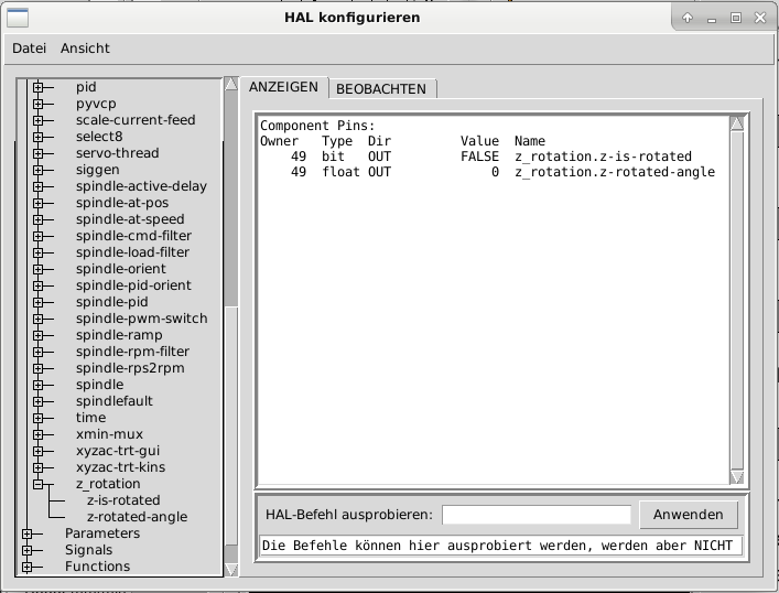

- 3D-Master
- Posts: 238
- Thank you received: 5
15 Feb 2020 15:46 #157454
by 3D-Master
did that, still the same: permission denied
when i comment out the pin "z_rotation.z-rotated-angle" and delete -WN from loadrt linuxcnc starts.
the component is working, i made some screenshots. Also i uploaded my config folder
thanks for helping me
Replied by 3D-Master on topic Parameters to classicladder possible?
You have to give read permissions to the folder also.

15 Feb 2020 19:11 #157475
Replied by cmorley on topic Parameters to classicladder possible?
you have:
loadusr -Wn python python/z_rotation.py
try:
loadusr -Wn z_rotation python python/rotation.py
Chris
try:
Chris

15 Feb 2020 19:17 #157476
by 3D-Master
THANK you its finally working

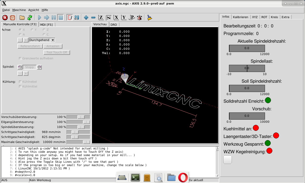

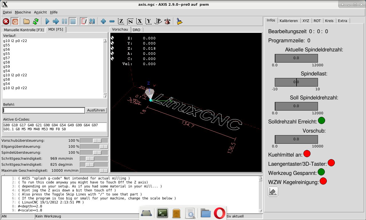

- 3D-Master
- Posts: 238
15 Feb 2020 19:35 - 15 Feb 2020 19:37 #157478
by 3D-Master
its currently on the bottom right under "WZW Kegelreinigung"
everything is still a mess, someday it will be pretty
and yes, on the Heidenhain controller the icon is also small (i made screenshots from the Windows simulator software). Maybe i will create bigger ones
Last edit: 15 Feb 2020 19:37 by 3D-Master.

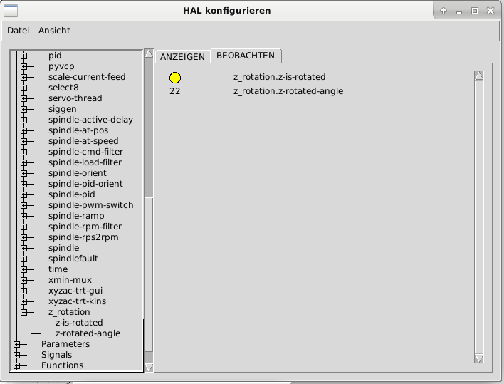

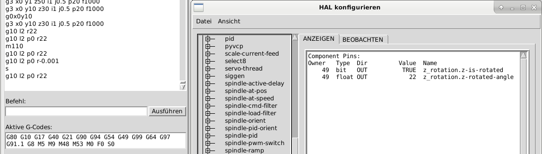

- 3D-Master
- Posts: 238
15 Feb 2020 19:58 - 15 Feb 2020 19:59 #157479
by 3D-Master
btw i went and used the "is-rotated" bit pin because classicladder seems to round up the float number
Last edit: 15 Feb 2020 19:59 by 3D-Master.
