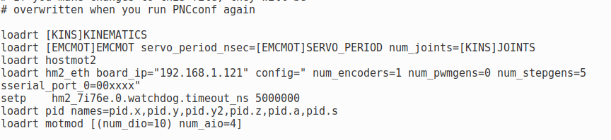

What should the end result be?
The line with DIO and AIO is wrong in some way.
If you want to use the 4 analog inputs on the 7i76e, you do not need to add lines to hal, you have to change the 7i76e mode to 2 from 0, done in the same line where the IP and stuff is.
sserial_port_0=00xxxx
has to be changed to
sserial_port_0=20xxxx
For digital IO , if they have to be connected to physical IO's on the board, also no need to add anything in hal.

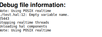

I entered num_dio=10 at the end of the loadrt [EMCMOT] and it works , no more faults
However I'm not able to modify the status of the digital output (M64/M65 commands)
I noticed on AXIS that M64/M65 commands are not Active G-Codes (MDI Tab)
It seems they are not present as available codes
