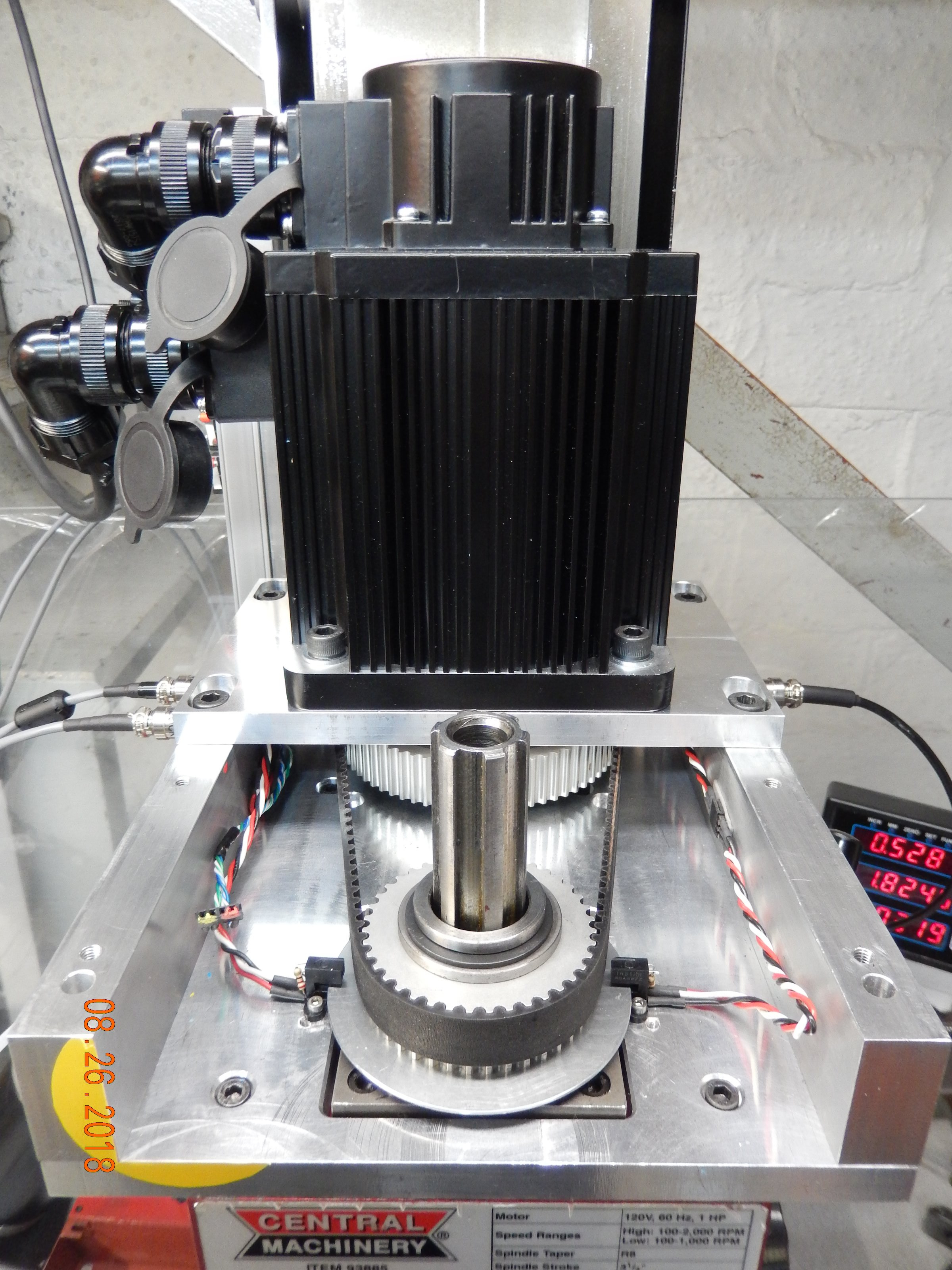

You could make that work. If it is geared 1:1 you can use the A/B/Z signals right from the encoder. On my mill I used the A/B signals that my spindle servo motor drive outputs and added a separate index signal to the spindle. This is because the spindle motor is geared 1:1.8. You will actually see two pickups for the index signal/ This is because the second one drives the a DRO that I also have on the mill.
Is that a 1kw motor? What kind of speed do you get out of that setup? I went with the 750w because it was the largest 5k rpm motor DMM had, figured I'd stick with the 2 step belt setup to get good torque upto 2500rpms and still be able to run upto 5k in high range. I really can't complain at all with this setup for this size mill, I haven't stalled the spindle yet.
25 Mar 2020 00:13 #161382 by JohnnyCNC
Replied by JohnnyCNC on topic Servo Spindle motor encoder Mesa 7i76e
It is the 1.8kw. Max motor speed is 3000 and I have it geared 1:1.8 for a 5400 rpm spindle speed. I have run it as slow as 150 rpm for some slit sawing. I saw another fellow that had his geared 1:2 for 6K top speed. I am getting good torque. The biggest endmill I use is 1/2 inch. I am able to do rigid tapping at 500 rpm. I could go faster but I don't need the extra excitement and drama. I have a second 24k water cooled spindle mounted on the mill for engraving and micro machining or anytime I want to do a lot of cutting with a 1/8 or smaller bit.
