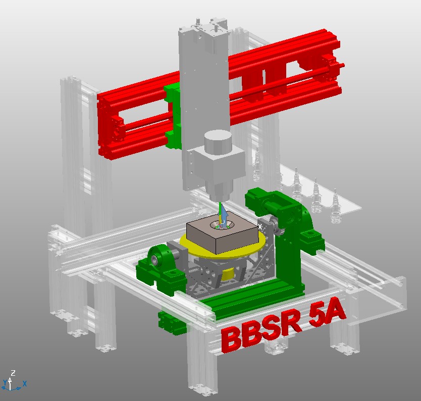

I'm working on a mill with a manual swivel head, an indexing b-axis without a motor. We use this with 5-axis xyzbc-kinematics to mill pockets at preset angles of the tool in reference to the table like in the image below but without the rotary table.
It's all working with the B-axis connected to a stepgen on a MESA 7i76e that does not have an actual motor connected to that particular output connector. I can command say G0 B30 and the DRO for the B-axis counts up to 30 and that is then used in the kinematic to calculate the movement of the X- and Z-axis.
So as it is the loop gets closed on the MESA board.
Now I would like to use that stepgen on the MESA board for another axis and have the b-axis working only in software.
I'm guessing I need to somehow provide the pid with a position feedback to get the DRO to function.
Does anybody have an idea if it is possible to close that loop in HAL and get the DRO to function?

I know my setup is not 5 axis simultaneous but rather 3+1.
However using trivial kinematics does not work here. It would work if the table were tilted as in your example. Then the tool would be perpendicular to the x and y joint/axis and circular interpolation would be possible with trivial kinematics.
But since we are tilting the tool in reference to the joints of the x and y- axis the interpolation plane is tilted by the angle of the swivel head and movements in x require two joints as do movements in z.
But anyway that was just to illustrate what I'm working on. The question was if it is possible to close the stepper loop in HAL or software and thus free up the needed step generator on the MESA board.

You do not need the PID or stepgen to get the DRO to function
if you are displaying actual positions, you just need to loop the
commanded position back to the feedback position for the B axis:
net b-pos-loopback <= joint.3.motor-pos-cmd => joint.3.motor-pos-fb
