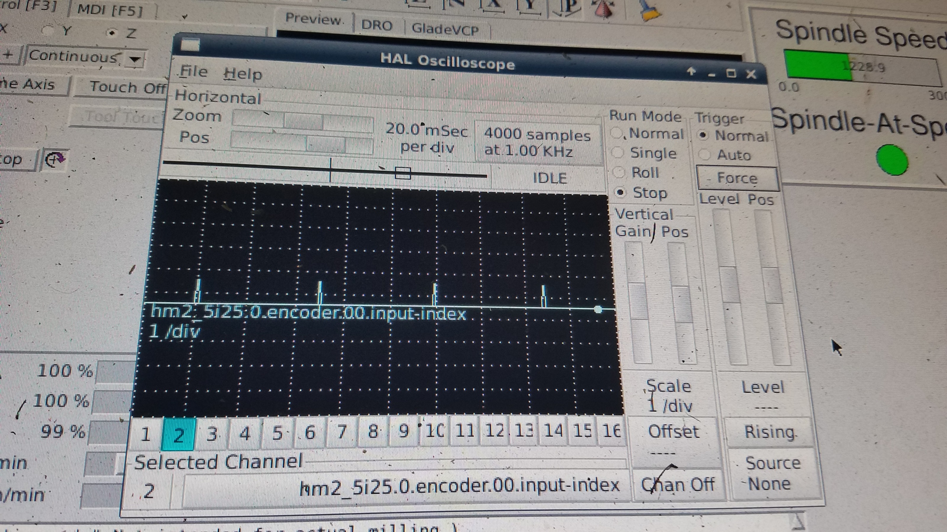

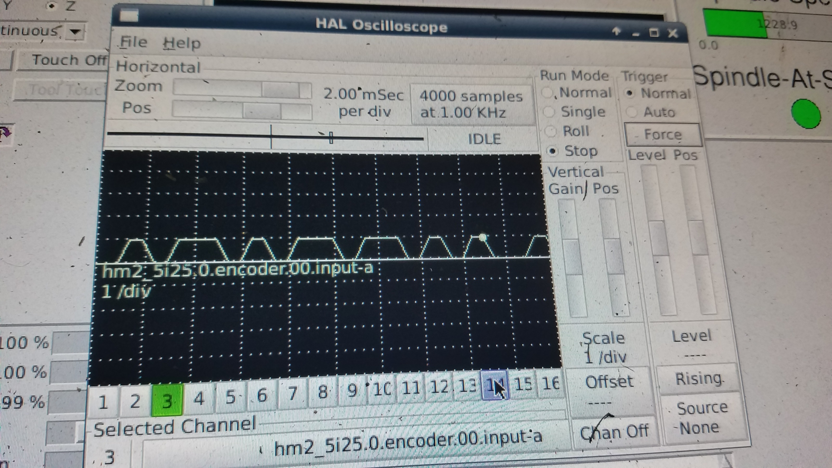

My goal is to move forward and restore the full functionality of my machine starting with closing the loop on the spindle with synchronized motion to orient the spindle for the tool changer and allow for rigid tapping. The computer is a dell 7020 with mesa 6i25 7i76 plug and go kit. I am using the original brushless permanent magnet spindle motor and the original 1000 count differential encoder with an Invertek drive. The motor is belted to spindle at 2:1 where max speed of motor is 4000 and the spindle is 8000.
On the 7i76 W4,W5,W6 are to the right.
The encoder connections on TB3 are a+ to pin7, a- to pin8, G to pin9, b+ to 10, b- to 11, +5v to pin 12, z+ 13, and z- to 14.
The drive connections to Tb4 seem to be correct, m3 forward m4 reverse and m5 spindle is free to spin by hand. Attached are some hal scope images for a b and index.
When I mess with the spindle PID some interesting things happen. The first is when I make P higher than 1 the spindle runs faster than M3Sxx and when less than 1 spindle runs slower than M3Sxx. I can increase P slowly to a large number and the only thing that happens is spindle speed scaling. Speed oscillates slightly then settles within 5rpm no matter what value of P I use (same as if I unhook the 7i76 and hook a potentiometer to drive). If I is increased spindle speed starts about where you tell it than drifts to the maximum spindle speed. With a low I this happens slowly and with a higher I it happens faster…
I am not sure if my problem is the hal/ini file that was created using pncconf, signal problem, PID values and or something else. Please advise on where to start.

With FF0=1, FF1=0, FF2=0, and P,I,D=0 spindle speed is roughly +-30rpm for s1000, s2000, and s3000. In the spindle speed display. I am sure the spindle speed display is using the encoder because I can see speed change if I spin the spindle by hand.
